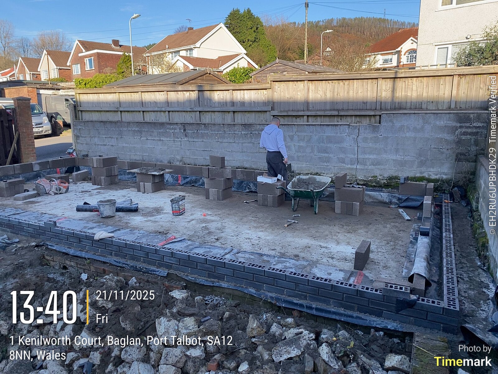

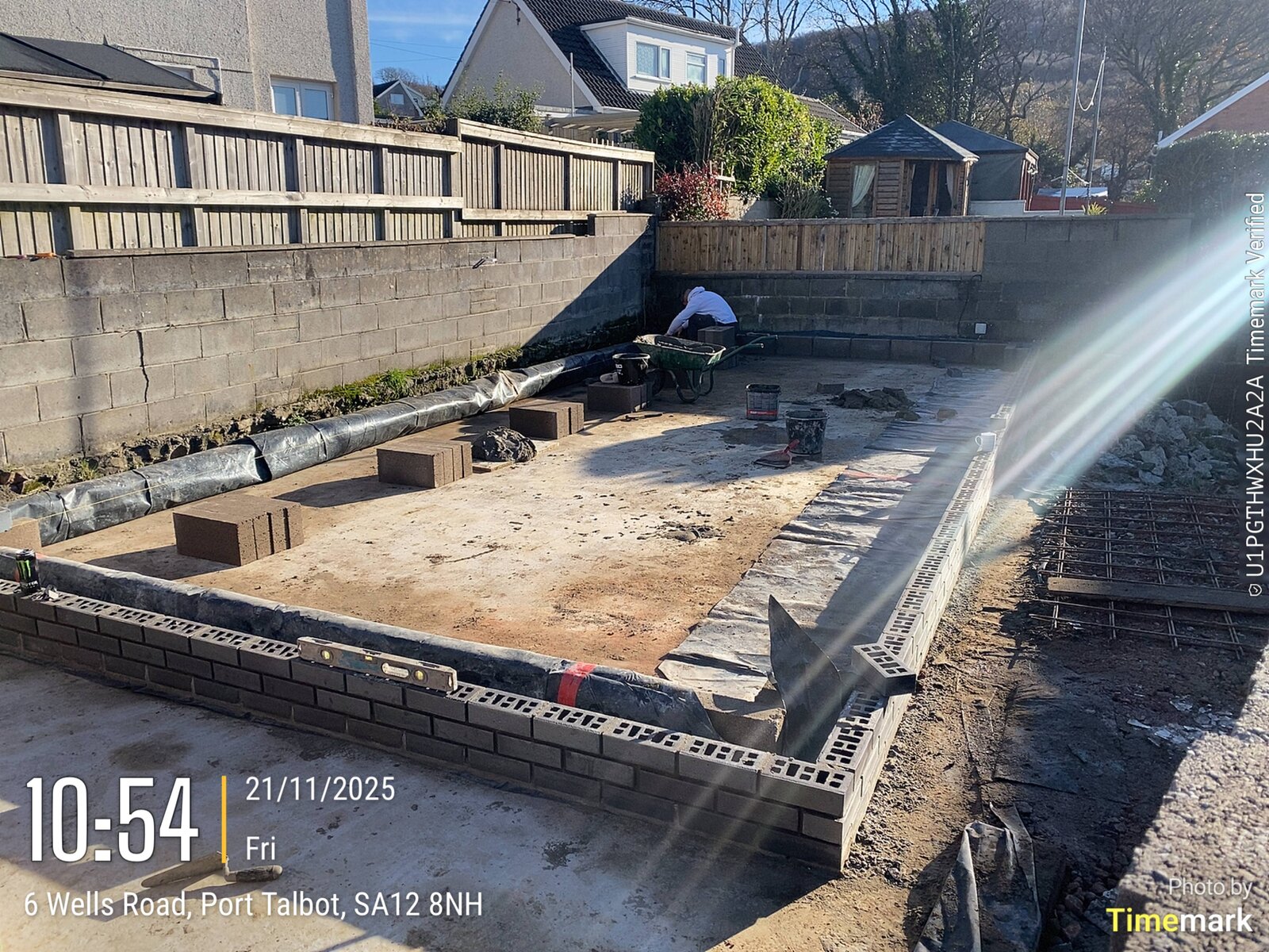

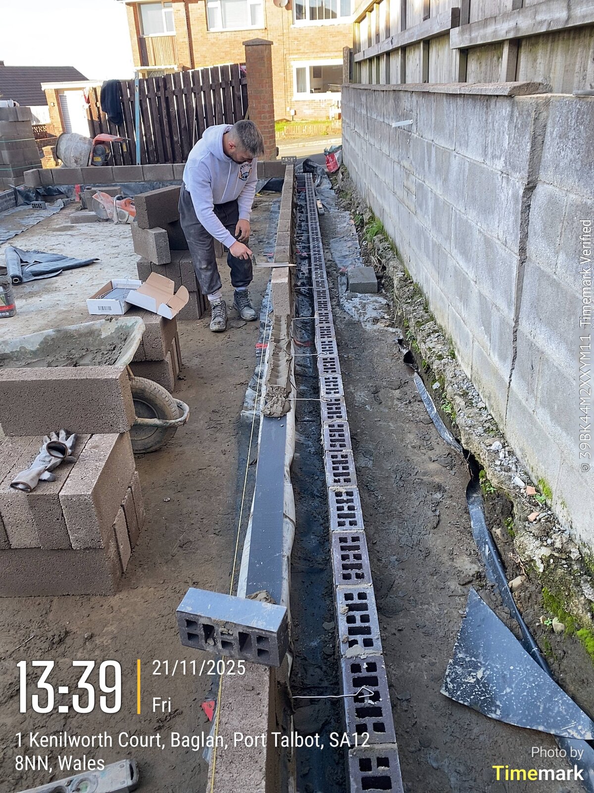

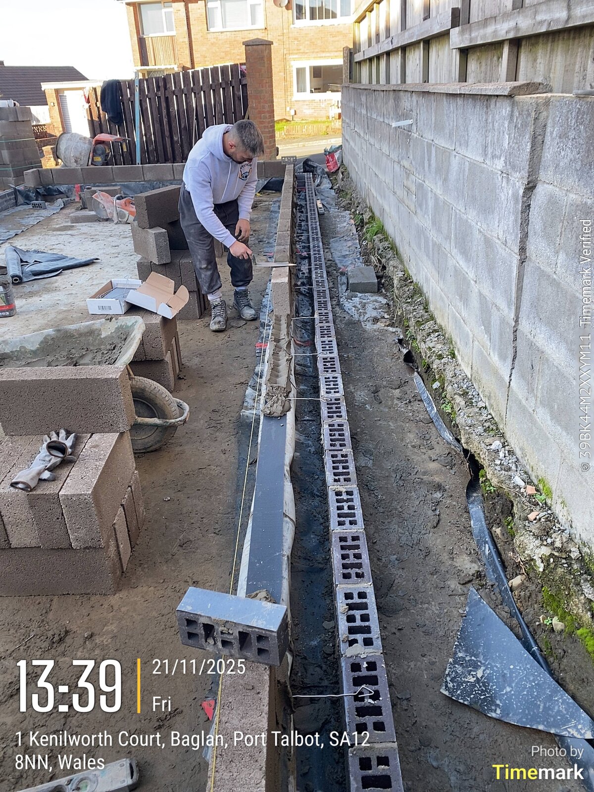

All sorted.
I misunderstood it.
100mm DPC is on inside.
600mm tray goes on next block course down to outside brick.
Radon barrier in as well.
