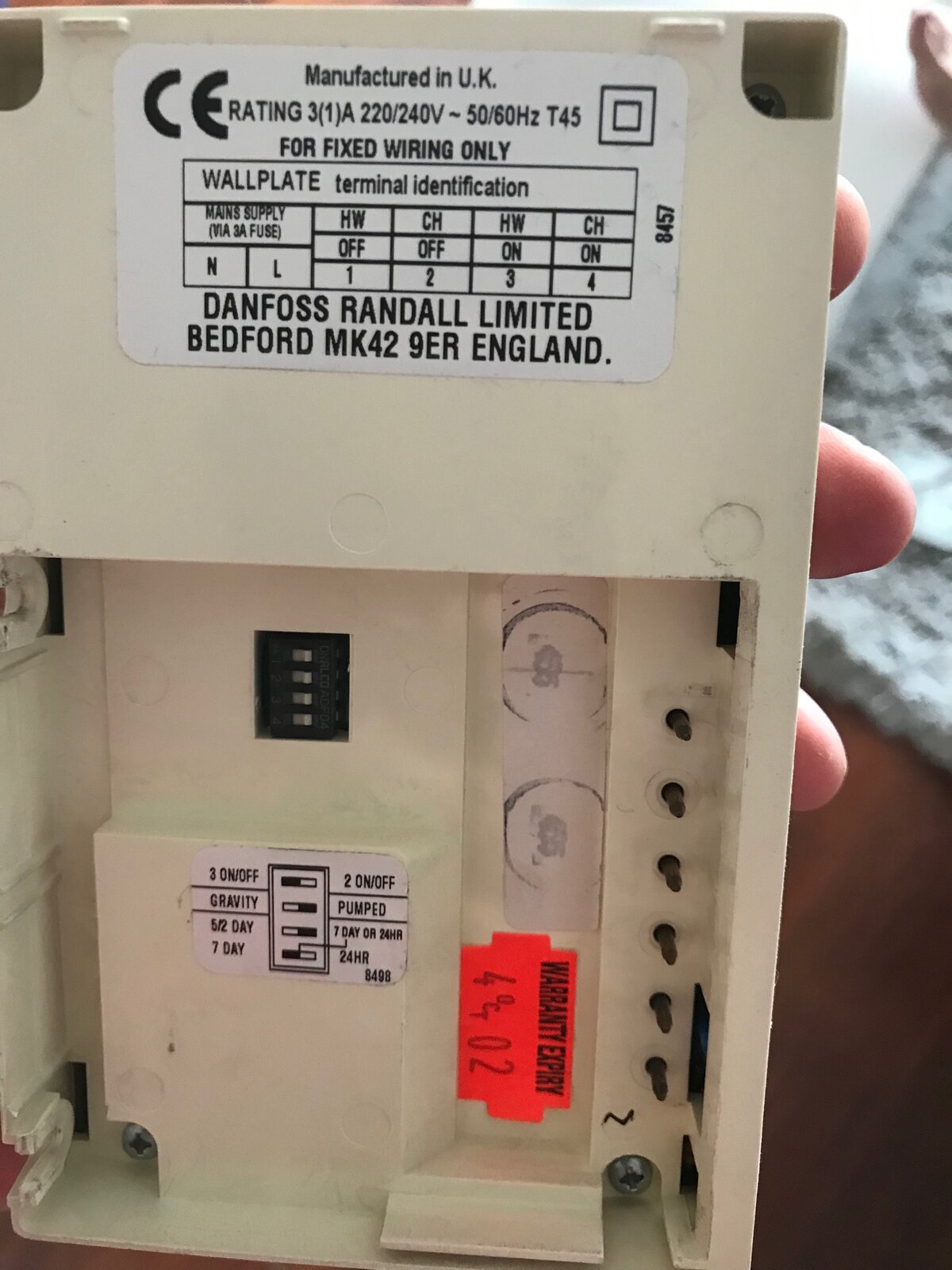

Hi
I believe our heating programmer might be broken but not sure.
Property : 2 bedroom, 2 bath flat on 6th floor of purpose built development, 5 radiators, 2 towel rails
Background : turning heating button off on "controller" (rather old Danfoss randall, picture attached ) in summers didnt turn the heating on towel rails off. We managed to turn radiators off via the radiator valves by setting them to 0. I wanted to call for help at that time but it wasnt a break down of hot water and i didn't want to invite anyone into our home necessarily during Covid time.
Situation now : we have hot water & heating works in all but living room. Living room radiators are cold. Pipe running to the TRV is hot. I have ensured that the TRV valve is moving up and down having done some youtube-ing.
1. Is the controller problem and 2 radiators not working now related? I feel they are not because pipes coming into those radiators are rather warm. its the radiators that are cold
2. Is heating programmer something i can change easily or a boiler engineer is needed?
3. Can you please recommend what will be the minimal effort replacement of the programmer that I have right now? Unfortunately, this picture is all the information i can give you on the programmer.

Have you bled the radiator in the lounge?
This rad not getting hot is not a programmer issue.
It might not be the programmer at fault, it could be a faulty 3 way valve, assuming your on a Y plan heating system

If all radiators except living room are heating up it's not your programmer.
I doubt you have zonal heating ,but it's possible.
Try this ,with heating on turn off every other radiator by its TRV except the living room . See if they now heat up fully.
