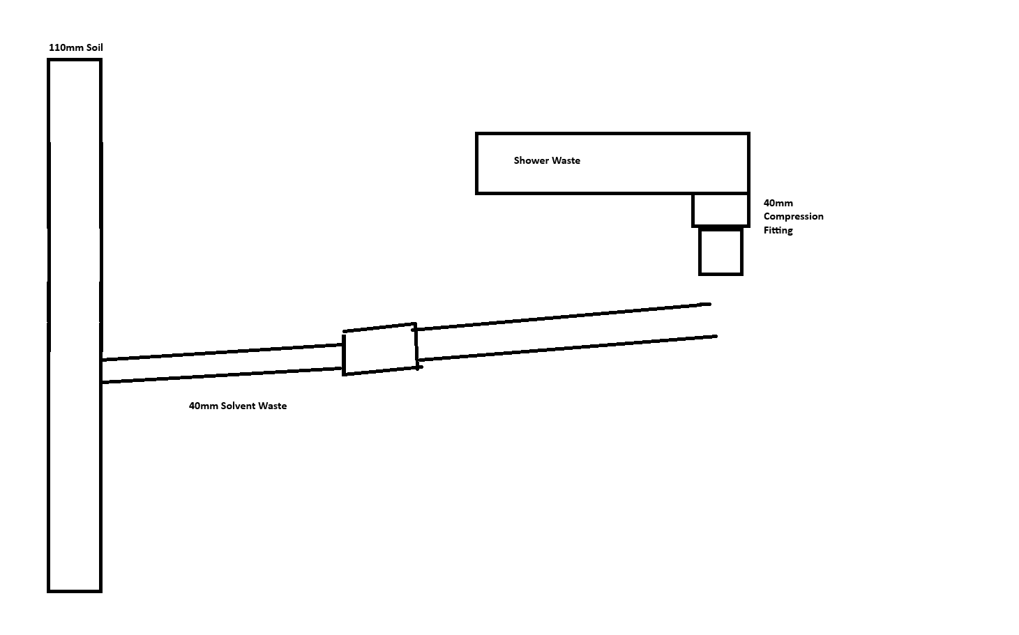

I’ve installed my shower tray and run a 40mm waste pipe from the soil pipe, as shown in my drawing attached below. At the moment, the 40mm pipe is only run up to the point where I plan to add a coupler — it’s currently cut and capped just to stop smells.
I’ve made an access hatch from below so I can fit the shower waste trap. The trap is a rectangular type with a 40mm outlet. The vertical drop from the shower drain to the horizontal 40mm pipe will be about 40cm.
The horizontal pipe from the soil pipe already has a slight fall, so I’m trying to figure out the best way to connect everything without it turning into a fight. Ideally, I’d like to use a solvent-weld coupler to join the final section to the existing 40mm pipe, but I’m worried I won’t have enough play to manoeuvre it into place.
I’ve seen people use some sort of slip compression connectors, but since it’s a shower waste I’d rather avoid compression fittings if possible.
One idea is to allow a bit of movement in the horizontal pipe so it can drop slightly, making it easier to slide the trap and pipe together — but I’m not sure there’s enough flexibility to do that. I’ll test-fit it first, although dry fitting can be tricky because solvent-weld fittings don’t always push fully home until the glue is applied.
If anyone has tips or advice on the best way to approach this, I’d really appreciate it.

Can you do any of that without the join. Flexibility wise non solvent weld is more flexible and as its a compression fitting at the shower waste if you can use a single length of non solvent without the join then no worries about that join.
A decent quality compression union will be fine, if it makes it easier.
Unfortunately i cannot replace that stretch as that part is already beneath floor boards. in hindsight i should i have kept it longer. I'm thinking to dry fit and see how much i can make it move around specially up and down. If i can move the horizontol one up and down then maybe I can just about slide the waste trap into place then lift the entire thing up and thread it in.
The length of the horizontal run is actually more like 30cm maybe even less. And the vertical drop is not that much either. Wonder are there any good quality flexible 40mm options that could potentially solvent weld on one side and fit into the compression waste fitting? If so how reliable are flexible wastes? Like if there are thin material could they potentially leak easier?
Flexible as a last resort, avoid them if at all possible.
