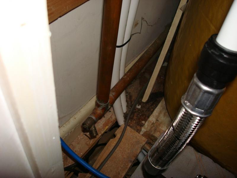

Advice needed for hot water feed to new shower pump
the vent pipe is just out of shot and is t'd off the copper hot water feed on the right.
The gunky stuff is some sealant, there is no leak, I just put it there as those compression joints are directly above the element, didn't want a leak, if it were to appear to drip into the housing and short out the 240v.
An unnecessary safety precaution if you like.

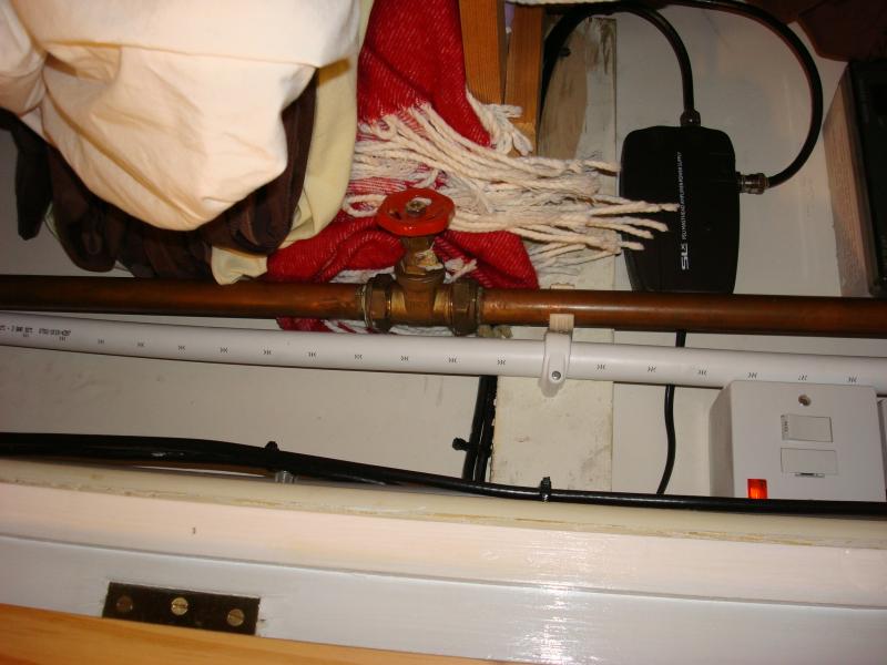

That brass gate valve needs to be removed - can't have one on the vent pipe here. If you must have one, it should be below the tee to the vent that you describe.
I'd check the feed from the cold cistern to the cylinder, for any blockages or restrictions.
you haven't got a cylinder stat have you ?
hot water over 65 degrees can cause problems with pumps cavitating.

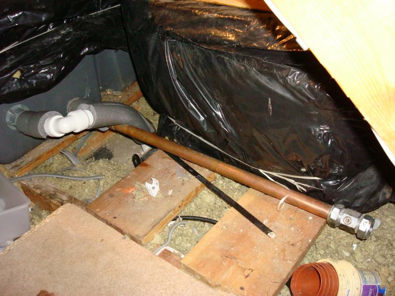

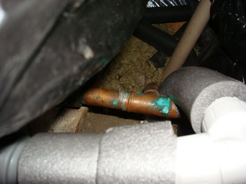

The pictures below show the HWT feed (the 22mm Copper) The stop valve half way down doesn't turn, other than that there is little too it, although there is a strange T piece in the attic going to a dead end.
I have enough 22mm Speedfit left to redo the whole run, although due to tight space I'll join it onto the copper on the horizontal part near the tank.
Just out of interest do I need a bleed nipple in it (as currently fitted) and would the horizontal part going into the tank be better off with a slight drop in it?
I think this gate valve is a likely suspect! It may not be fully open. You may be able to free it, or it may need replacing - possibly with the one you need to take out of the vent pipe :) Alternatively, a full bore lever valve would do the job.
While the cold feed is empty, it would be convenient to cut and cap off the dead leg, close to the tee.
If the old gate valve was restricted, I'd put it back together and test it at this point.
Unless parts of it are in 15mm, it would probably best to upgrade the feed to 28mm, if it still needs doing once the gate valve is on.
Yes, the drain point is there in case you need to empty the cylinder. It won't matter that the pipe is level, as the water is flowing through under pressure rather than just 'running downhill'.
