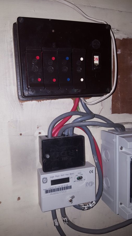

Hi we have moved into our new house about 3 weeks ago and noticed there is a old fuse/trip box , which is annoying if the anything trips out etc as I would have to rewire the fuse . Does anyone know how much it would cost for an electrictian to fit a new and up to date box ? And what one do I get ?
Here is the photo of the old box we have. Think it was fitted in 1998

You can obtain spare fuse holders and have them wired ready for replacement or
Plug-in circuit breakers.
Is that a shower unit to the right? Just wondering, no problem.
3, 4, 5 hundred depending where you live and what you want.
1968 more like.
Nah. My Mum's early 80's house still has this exact fusebox. Fantastic bit of kit.
Agreed probably not 1998 though!
To the OP - pre-wired (edit - spare) fuseholders are a good plan. That said, fuses shouldn't be blowing frequently enough, and if they are, then there's some other issue that needs resolving.

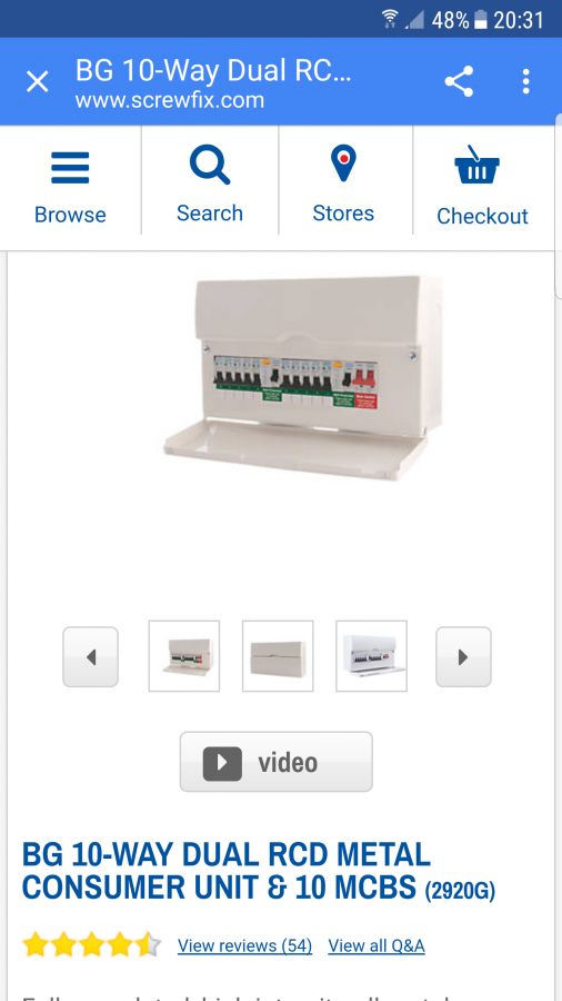

I have seen on the screwfix website fuse trip box start from £70 but that's only way. Obviously the dearest ones are 16 way fuse box but I wouldn't have a clue what 16 way means ??
Well, 16 way means you can have 16 MCBs. You wouldn't need that many.
However, if you chose to have 16 RCBOs (MCB and RCD in one) then that is 16 times 20 or 30 pounds for a start.
In this case, with just 5 circuits, I think RCBOs would be the way to go.
You could fit a 5+5 (10 ways, two RCDs) but there's going to be a lot of empty space
So you think this would be ok for me then
You'll need an electrician to test the circuits and fit the consumer unit, so it would be better to ask him which one to fit.
Unless you have future electrical work planned you dont really need a dual rcd box.
A normal box with just a main switch and 5 individual RCBOs may be better, but as said it may get more involved and costly to DIY.

As far as the fuse box goes, IIRC, that design with the wooden pattress and brown unit goes back to 1956.
Not saying yours does, though.
