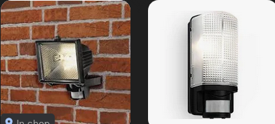

We have 2 outside lights above the front door. An outside socket and security light at the back that hasn’t worked in ages.
I would open them all and look for water. Look at most outside lights and the PIR is at the bottom 1735739828384.png just waiting for any water to run down into the PIR, last house I drilled a small 1/16" hole in bottom to let water out, but to drill without hitting any components in the PIR is hard, I removed it to drill hole, this house don't use PIR's.
I would open them all and look for water. Look at most outside lights and the PIR is at the bottom View attachment 367627 just waiting for any water to run down into the PIR, last house I drilled a small 1/16" hole in bottom to let water out, but to drill without hitting any components in the PIR is hard, I removed it to drill hole, this house don't use PIR's.
Hmm water surface tension would prevent any water draining through a 1/16" hole.
