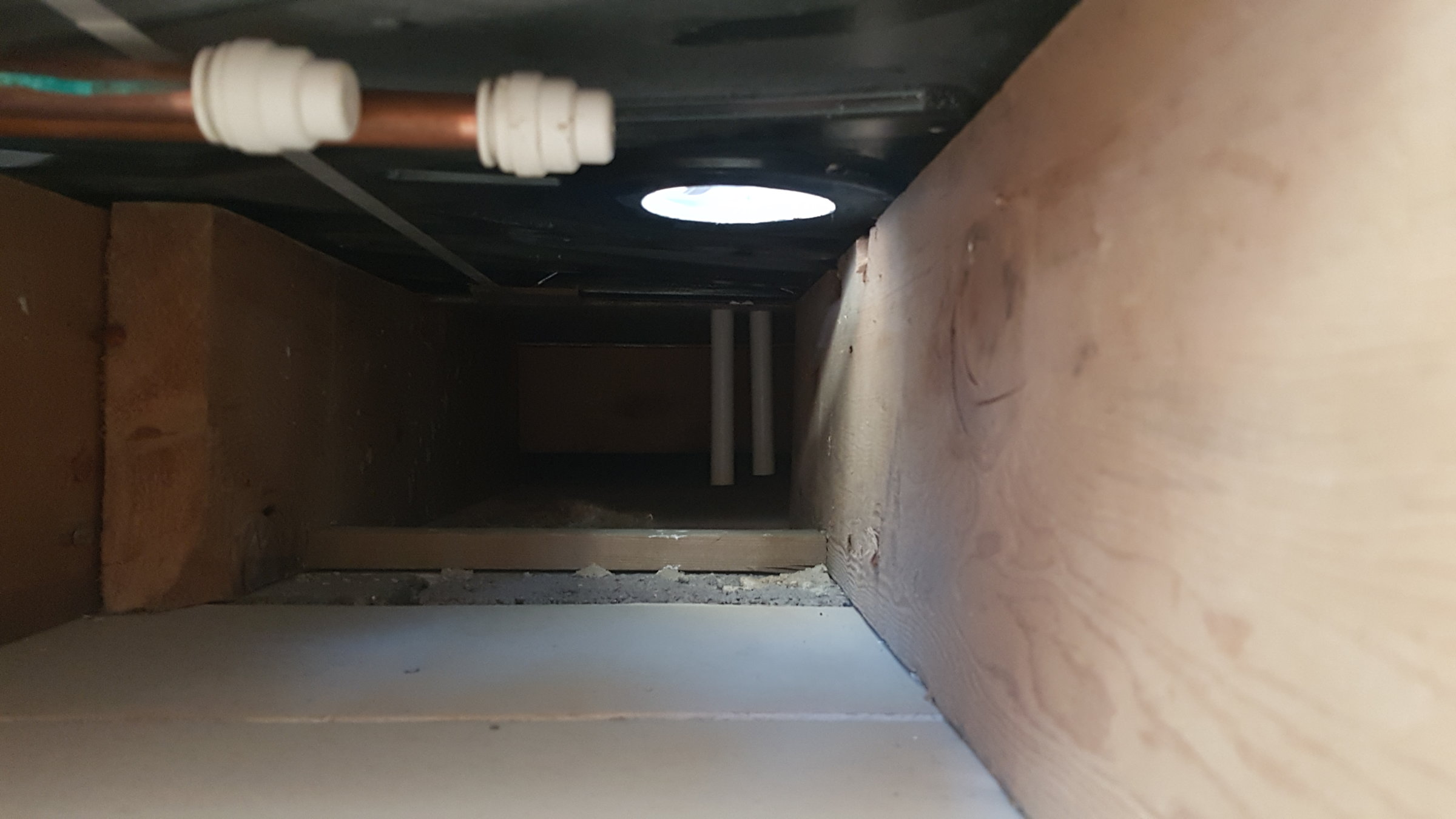

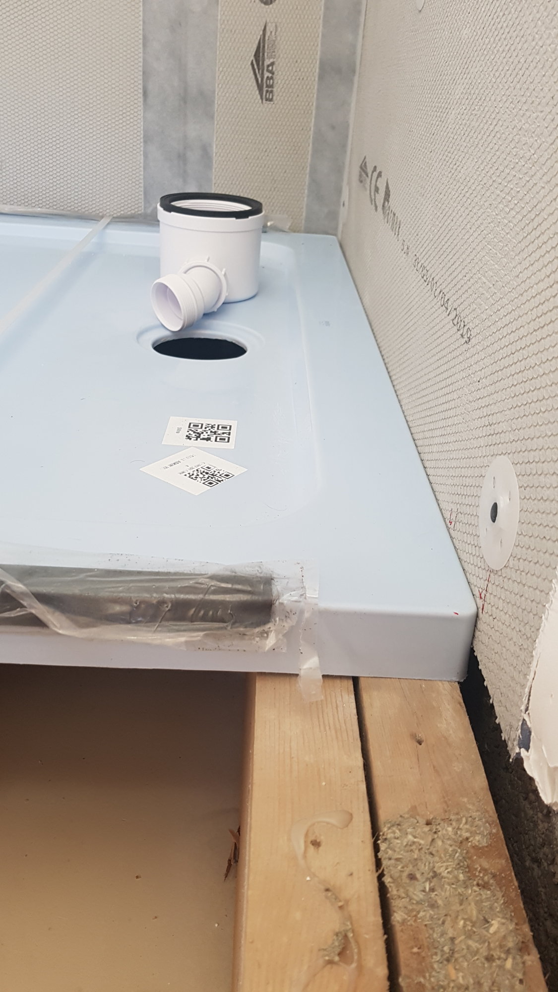

As I'm sure you experts will agree, joists always seem to be in the wrong place and while mine could be worse, it could also be better.
I have placed the shower tray in position to get a view on how the McAlpine fast flow waste will fit and the good news is that it will fit, however, it is too close to the joist to run the 40mm waste pipe straight through the joists and external wall as I had intended.
Here are some photos to show the issue:
The last photo is the view from the side of the tray showing how close the trap is to the joist. This joist is the one that the waste pipe needs to run through and then through the external wall.
I suspect I will need to position the trap, so the connection is pointing away from the joist (like I have positioned it on top of the tray) and then use bends to run round to the joist. Using "sharp" bends so close to the trap concerns me as I want to ensure the flow is not restricted too much due to the shower tray being low profile. I did wonder about using a flexible piece of pipe, which would allow a more gradual bend around to the joist, but I'm not sure if this is a good idea.
I would appreciate any guidance on the best way to connect this trap to the waste pipe that needs to go through the joist. I confess, this is my first attempt at doing something like this.

Would it be possible to turn the trap away from the joist and turn the outlet down if needed into a solvent 135 the with enough pipe between to drop to the required level,then make a solid loop out of 135's instead of a flexie?
Would it be possible to turn the trap away from the joist and turn the outlet down into a solvent 135 the with enough pipe between to drop to the required level,then make a solid loop out of 135's instead of a flexie?
Thanks, that's a great idea. I hadn't considered using 135 degree elbows, but I like the idea that the bend would be more gradual than when using a 90 degree elbow.
Having never done this before, I'll have to buy some pipe and bends from screwfix and experiment, although I do have the 135 bend that came with the trap.
I suppose the other advantage of using even a short piece of flexible pipe is that it gives a little more room for error!
Those 90 degree fittings should never be used on wastes - the 92 degree ones (y) are swept. As to the 135's - you can get M+F ones so more variations can be done than just F+F. Set it all out dry, then put a pencil mark across the socket/pipe joint. It'll all glue together accurately.

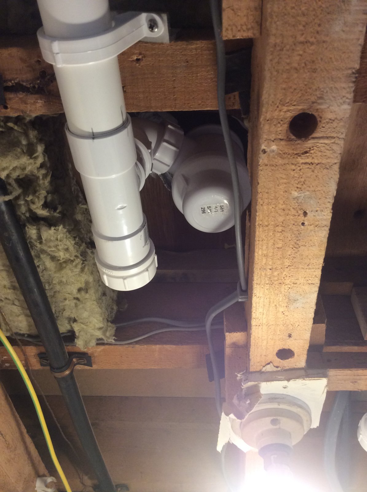

Today I found a pack of Floplast 40mm solvent 135 degree elbows in my plumbing box, so thought I would try to see how the run from the McAlpine shower trap would look. Unfortunately, I realised straight away that the existing 40mm waste, which is stamped with "Marley Extrusions" wouldn't fit into the Floplast elbows. The diameter of the elbows is much too big for the pipe! Initially, I didn't think the pipe would fit into the McApline shower trap as this trap has an insert that fits into the pipe. After cleaning the end of the pipe I managed to push it in, but it is a very tight fit. Unfortunately, I have to use this pipe as I have an existing pipe run outside that I will be making use of and just need to fit a new length of the pipe through the wall to connect up to it. Due to the way my old shower was fitted, I was able to recover a reasonable length of the pipe to re-use it.
Any idea why the Floplast solvent fittings are too big? Is this likely to be the case with all solvent fittings? The fittings used for the old shower are Marley push fit. I suppose I could buy some of these seeing as they haven't leaked in 22 years!
I had a look on the Marley website and they listed three types of 40mm waste pipe and fittings that I would be interested in; pushfit, solvent and ABS. Not sure what the difference between solvent and ABS is, but they both appear to use solvent glue! There doesn't seem to be many places online that sell Marley.
Despite the incompatibility of the Floplast and Marley fittings, a rough mock-up did show I could use 3 x 135 degree elbows to produce a gradual bend from the trap.
That may well be your issue, Push Fit and Solvent weld are not compatible. IIRC push fit is a slightly bigger OD and doesn't fit the McAlpine traps with the insert in the outlet very easily, whereas solvent weld is a snug fit.
All solvent weld systems should be compatible, across the manufacturers, but push fit systems vary. Push Fit is also made from Polypropylene, which cannot be solvent welded. Only way of joining the two types is a compression waste fitting, but if in an awkward spot under a floor, these are better avoided.
MUPVC and ABS are different types of plastic, both will solvent weld, hence the 2 different types listed.
