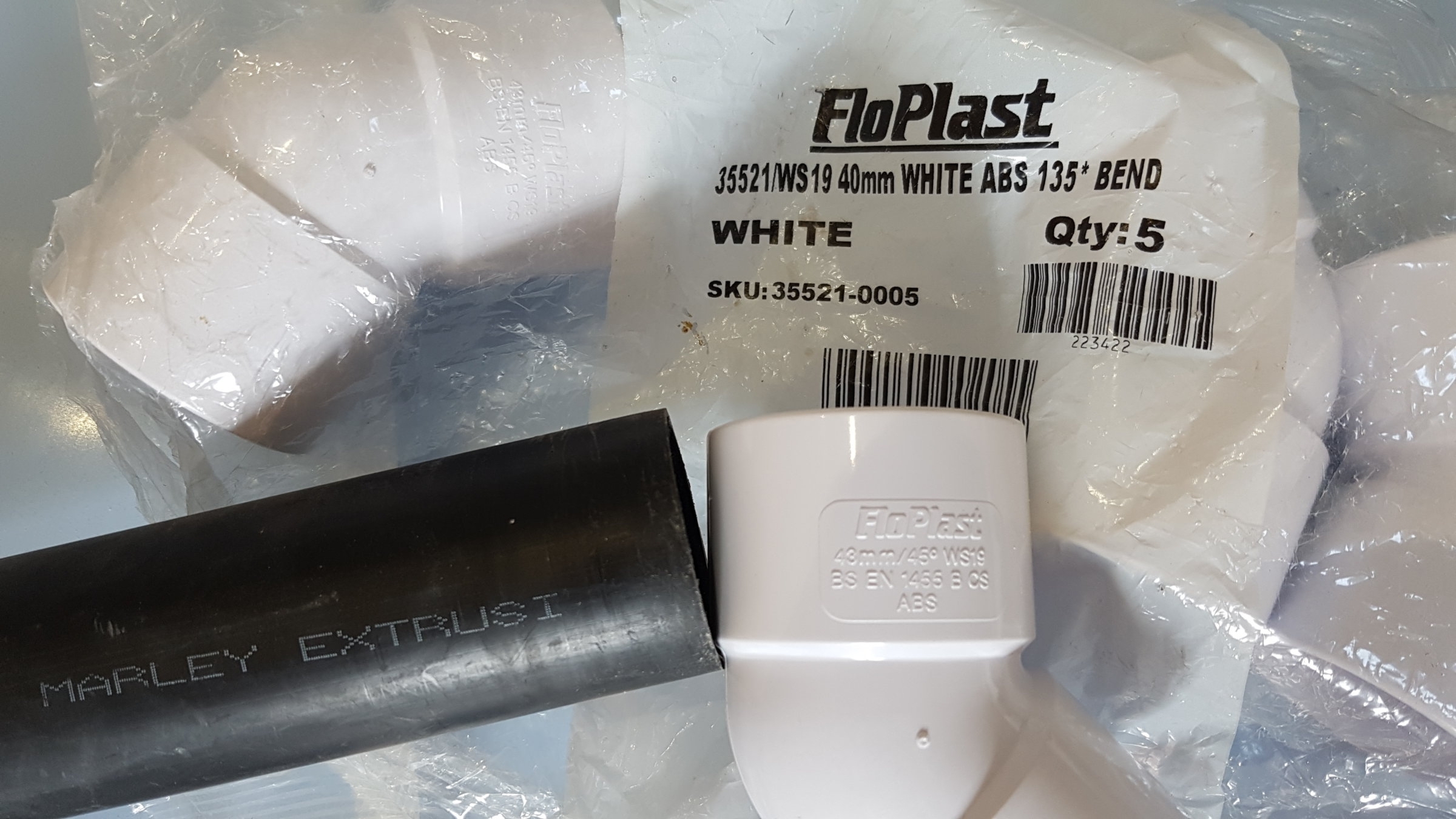

Yup, I'm sure the push fit PP pipe is larger OD as well so if it's solvent weld elbows you have then they should be too small, not too large. Are you sure it's 40mm waste you have there? Measure the diam & let us know, if it isn't 43mm then not too sure what pipe you might have.
Marley do have a push fit range but again the pipe should be larger than solvent weld fittings you have if they follow standards.
Let us know what the diameter of the waste pipe is.
