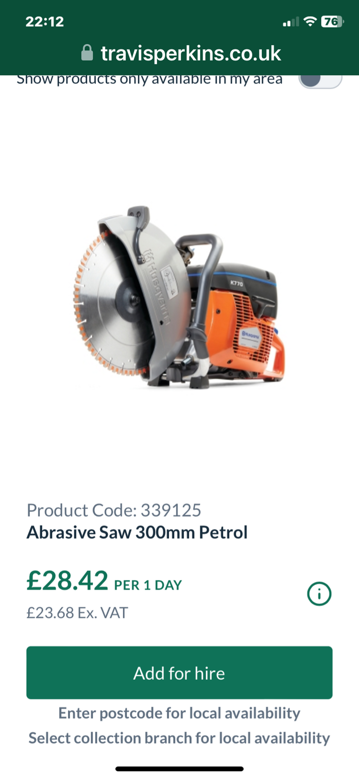

Cutting a trench with the grinder and diamond blade will do the best job and you just need to get a hosepipe trickling a stream of water onto the blade as you cut which will keep all the dust down. You can hire the disc cutter with the attachment from a hire shop if that is better for you but that option will work well.
It would likely shatter the slab.
Proper tool for job.
