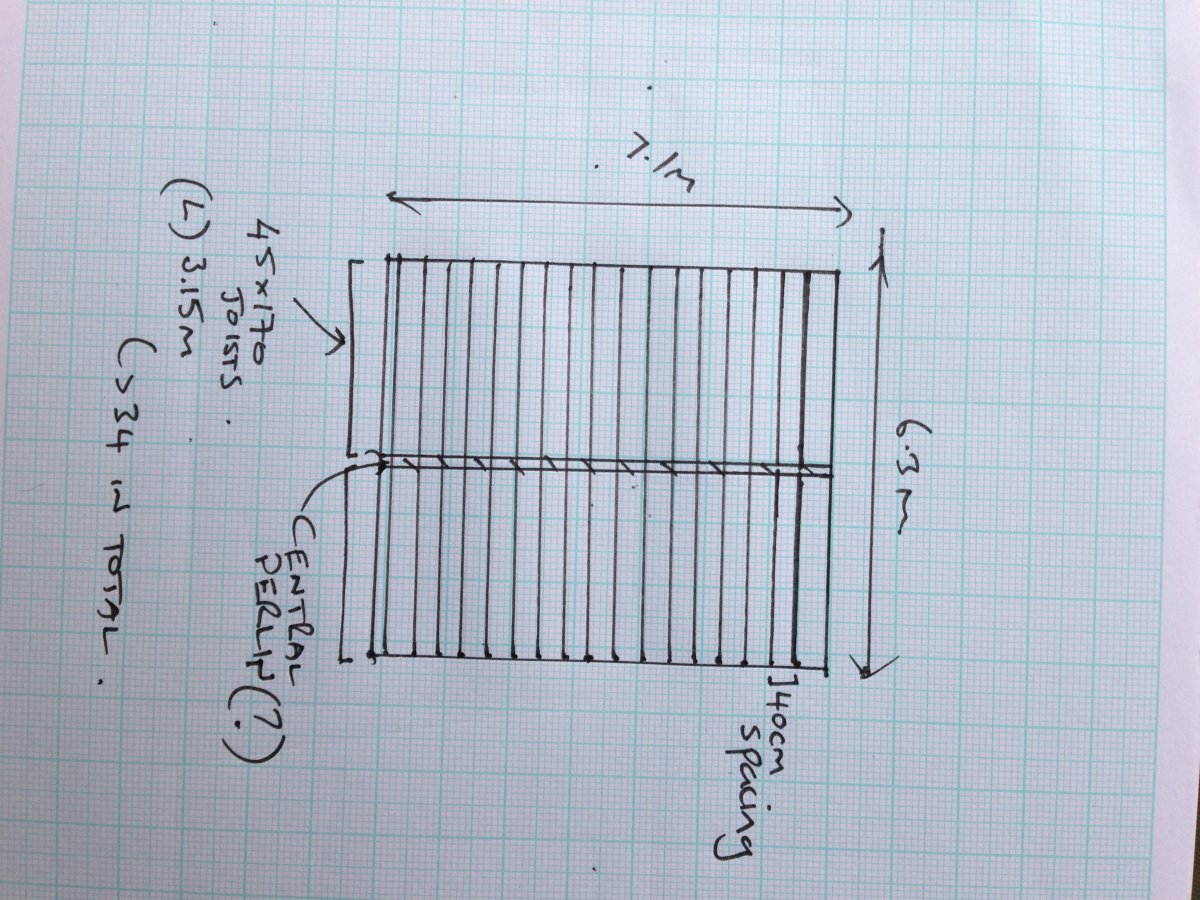

I'm planning an outbuilding build approximate dimensions -
6.3 m x 7 m
(large double garage)
Can anyone advise on the type / size of joists required?
Is it best to have a central support also and running shorter joists off this?
Thansk for any advice.
Gavin

For the central purlin would a 75 x 220 wood beam be strong enough? I can get this as long as 7.2 meters so it would reach.

Heres a couple of sketches of the building and potential roof truss pattern. Thanks
I doubt you will find a timber product deep enough. Your suggestion will not even be close. You need to have this building designed, especially as you are gonna need building regulations.

Noseall - can you recommend the type of professional I'd need to contact to get the calcs done?
Thanks again
A structural engineer can have a wee look at your proposals, especially the roof timbers, steels, any large openings, wind loadings to walls and roof, foundation sizes (trees and shrubs nearby etc) and floor detail.
