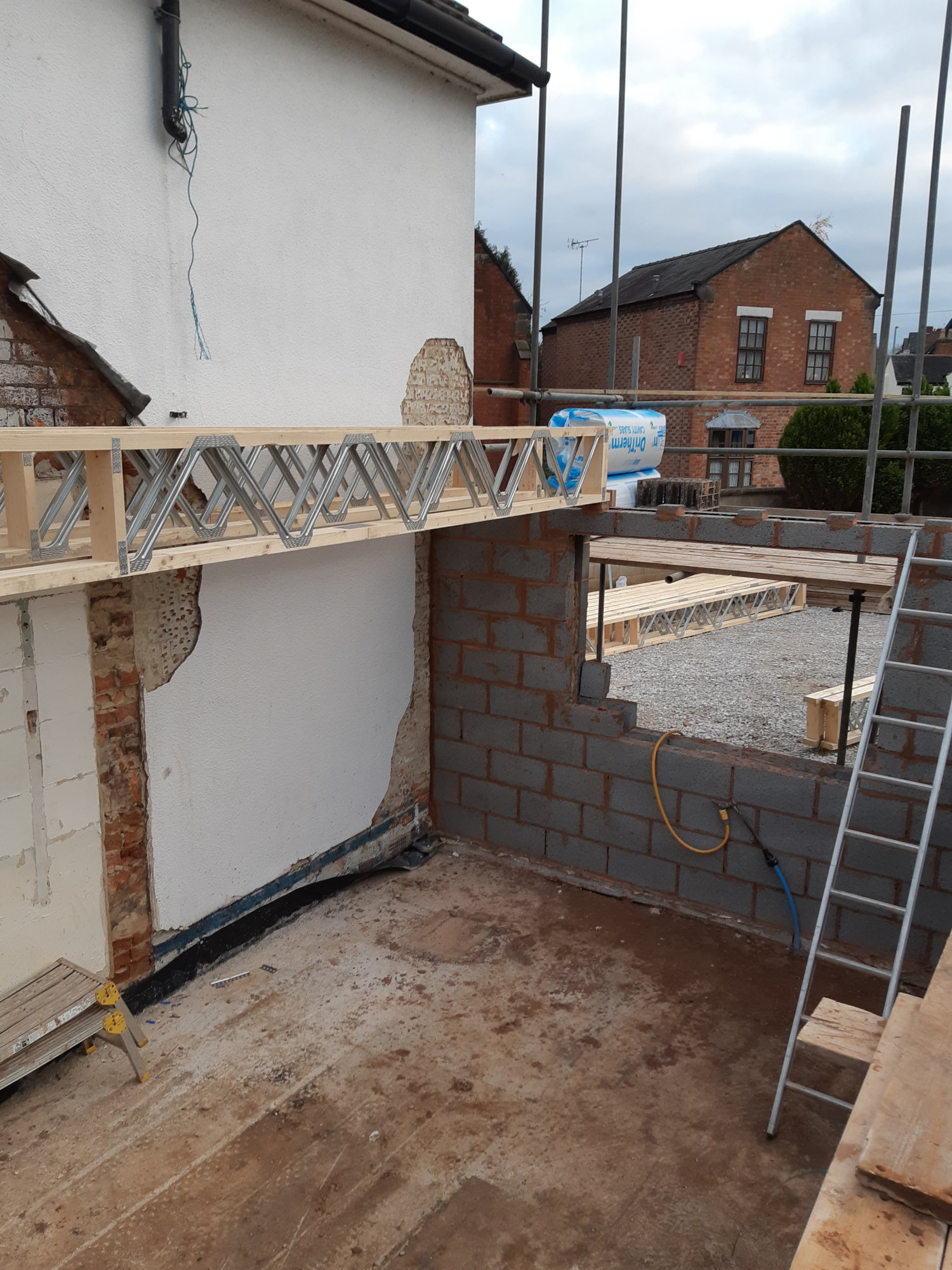

I am building a workshop, the plan was for 8m x 5m which planning & building regulation granted permission. But would like to have more space and build it bigger.
The new plans will be for 10m x 7m.
I am stuck on the flat roof design, any advice is greatly appreciated.
How should I design the flat roof? Use RSJ? Span distance? Suitable size joist? RSJ? Max Centres? etc.

How about glulam beams?
90 x 405 has a loading of 2.4t UDL over 7m length.
2 glulams, 1 at 3.3m one at 6.6m. Then you could use 175 x 45 joists in between.
A 7m 90 x 405 costs about £250+vat
Im not a SE so above is just an idea, so its not professional advise.
The snow load on a 70m sq roof is a lot!
We are currently using Posi-Joists on a 7.1m clear span and they are big bu££ers! 120mm top and botton chords and 421mm deep. £2880 all in for 15 units.
The blocks look tiny compared to the joists
Wow that is a big joist, If there is no other alternatives I'll see what the best price I can get the joist for.
I did message a few SE but probably cheaper to use I beam jji etc.
Thanks for the picture it gives a good idea on the size.
