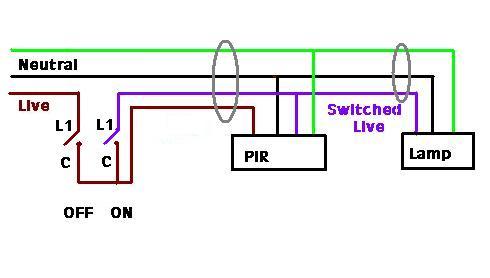

Just get the spark to run 3core and earth out to the porch light from the switch then you have flexibility to do what you want later

Can you get lights which I can switch between sensor and turned on until I turn off?

Using 3c and earth means you could have and on/off/on switch in the hall AND with an appropriate light or PIR have the ability to to have the light on, off or on PIR sensor
Beware lots of lights with PIR built in don’t allow you to do this.
Putting the cable in now just gives you options

So it might be hard to find a outdoor light with a PIR sensor, ability to turn light on and off on a permanent setting, and off altogether?

I have had a sensor I bought from Lidl outside my house working faultlessly for years and I have wired it as bernard suggested such that an indoor switch can be used to override the sensor and bring the light (4 of them) on continously
