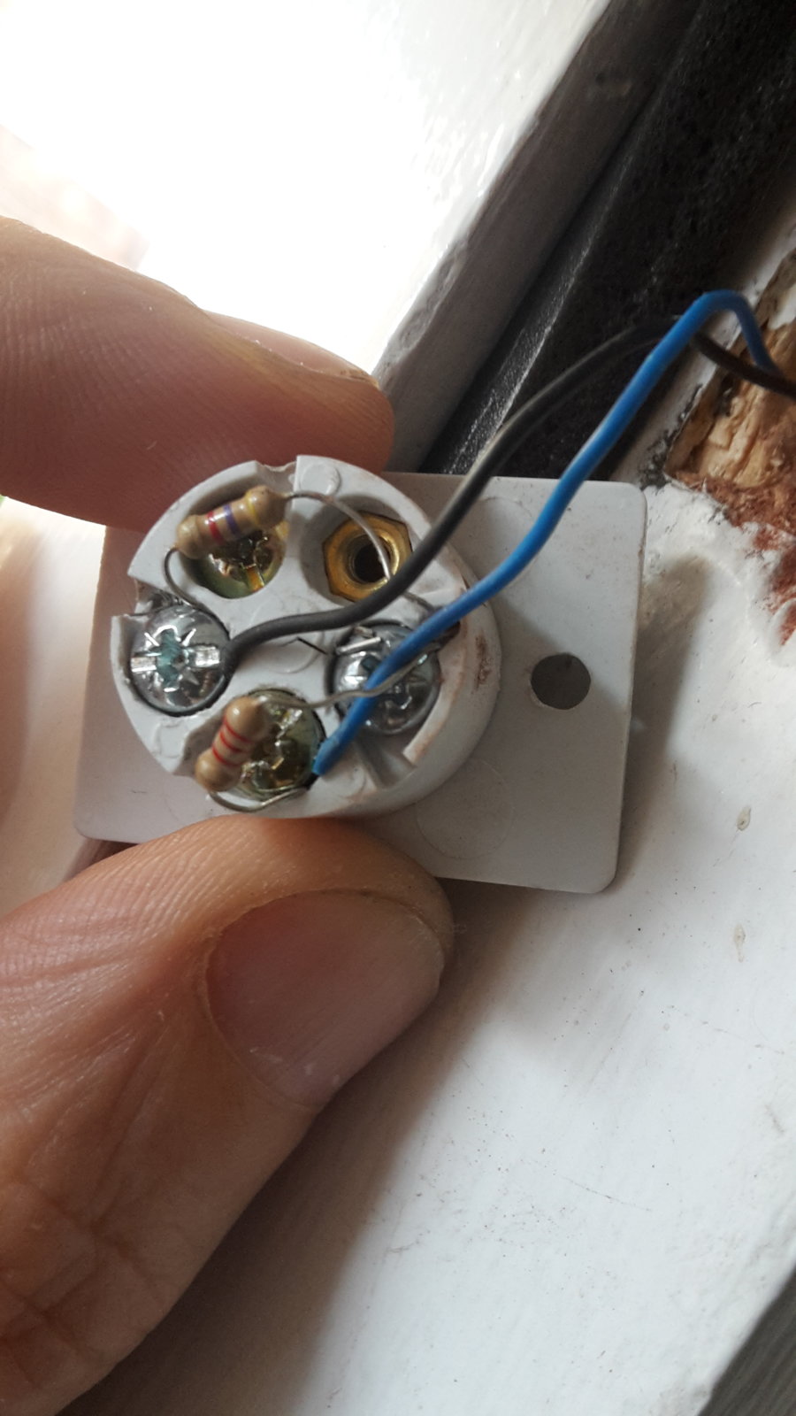

Hi, apologies for reviving an almost 10 year old thread but i was wondering what the solution to this problem was. Dodgy contact or dogy wiring?
I have the same issue...moved into new property 3 months ago and all of a sudden (in the middle of the night!) the 9651 internal sounder went off with 'front door tamper' error message on keypad (i haven't recently done anything in terms of moving carpets ets). I disabled the sounder with the user code but the error light stayed on and the sounder keeps randomly going off when it wants (after 30 seconds, 2 mins, 5 mins etc) or when i open the front door.
Whoever installed the system did a good job in hiding all the cables (both inside and out) so i'm thinking of just linking out the tamper connections at the control panel as i don't think i really need them - do people agree?
Found some paperwork that goes with the system and it says 'door contact replaced' due to tamper error in 2018' (doesn't say who replaced it). Might be that the door contact has failed again - but if i just link out the tamper at the control panel should this sort the problem?
There are only two core wires going into the two silver screws on the flush door contact (which have capacitors bridging them?) and another two cores are twisted together and pushed behind the contact but not physically screwed into it (i assume these are for the tamper loop?). I haven't checked continuity for anything yet. (What i think is confusing me is, even if the door contact has failed (again after a year?) can this be what's causing the problem even though the tamper wires aren't connected to it? I wouldn't have thought so but happy to hear thoughts.
Could it be an old internal battery or would this have nothing to do with the 'tamper' error message?
Yet again, apologies for dragging up this old post and any advice would be greatly appreciated.

Check the connections on the contact are secure.
Possible problem are poor connection, damaged cable ,faulty resistors, faulty contact.
Cheapest solution is to change door contact and resistors.
Fault battery would report battery fault on display.

Update: checked the internal battery (a good while after I'd disconnected the mains) and it read 13v. I linked out the tamper at the PCB and put everything back together- but no luck, I was still getting a 'door tamper fault' and it was triggering the internal alarm randomly or when I was opening the front door.
Was thinking it may have the bell box battery. Went up the ladder opened up the box but couldn't figure out how to remove the battery - which I think I can just about see behind a perspex inner covering - which I couldn't unclip. Linked out the bell box tamper and 0v at the PCB. Put it all back together but still no luck and still had the 'door tamper error'.
Finally went to get a new door contact and swapped the old with the new using the old resistors. Put everything back together and no 'door tamper fault' as yet (admittedly only 30 mins so far). Looks like this may well have been the problem - but I'll report back in a day or two in case it ever helps anybody else.
Admittedly, I know nothing about electronics (I just have basic DIY skills) but could somebody please explain why separate resistors are needed for the door contact (as per my picture)? Why can't it just be used out of the packet by screwing directly into 2 of the terminals? (As you'll see, no tamper wires are screwed into the door contact, they were just twisted together and stuffed behind the old contact- which is what I've done. I may eventually change this and remove the various links at the Pcb) but for now, I just want to make sure there's no further errors.
Thanks again, handymanjo.
B**locks.
Internal sounder just triggered with same 'tamper front door zone 1' error. Arrrragh.
Could it just be a knackered PCB?
