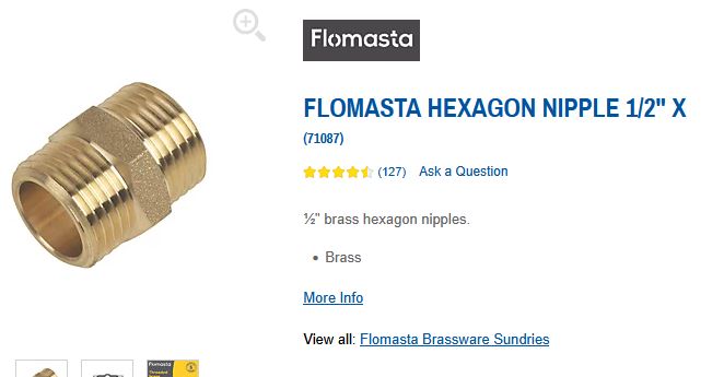

Buy two of what you linked above and a 1/2" brass nipple like this.screw it onto the filter and your flexis will then fit ok.

Is there a way to mount once side with solid connection ? Are there any connectors that will give me the g1/2 connection directly on the 15mm copper? I got two of these flexis but by the time I put the filter in the middle it becomes quite long and I don’t want to force bend the flexi as that put strain on the filter housing which is plastic. So thinking to have one side a rigid connection and maybe other side flexi. Will most definitely need at least one flexi otherwise I won’t be able to unscrew the filter housing to remove the cartridge.
PTFE on the threads, not a washer. Same with all on the search.
