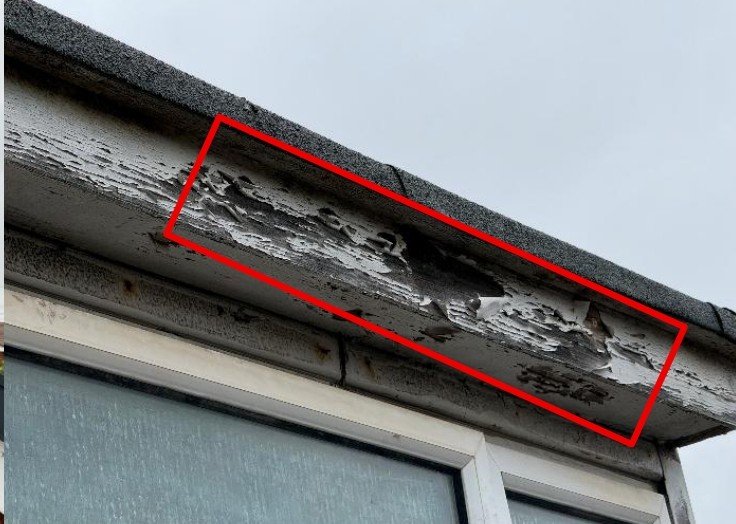

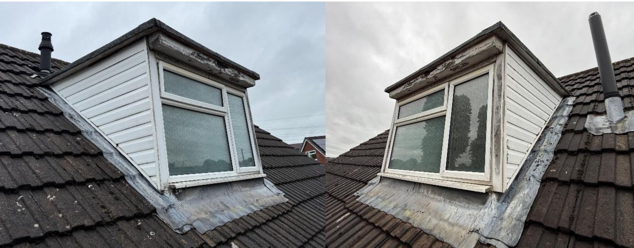

1. Timber fascia/soffit above the dormer
Most of the main roof fascia and soffits are uPVC and were described as serviceable, but there is a short timber section above the dormer window. The paint is badly flaking and the timber looks heavily weathered.
The surveyor said there was no obvious structural decay and recommended preparation and repainting. Does this look like something that can realistically be stripped, repaired and repainted, or is replacing that timber section likely to be more sensible?
I’m also wondering whether the roof-edge or felt detail above it could be causing the repeated weathering.

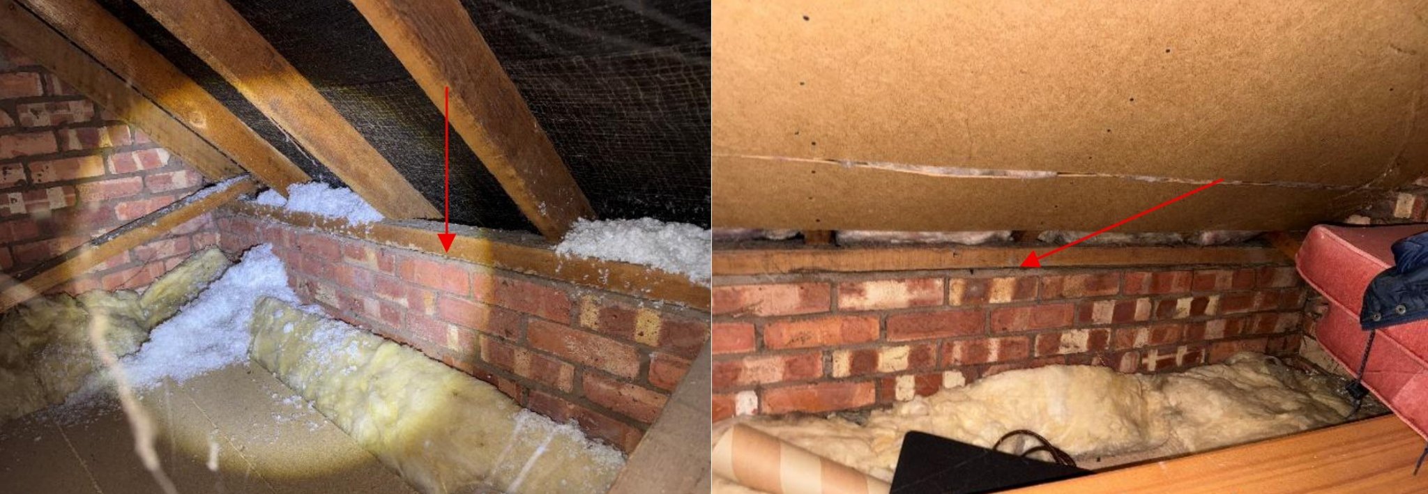

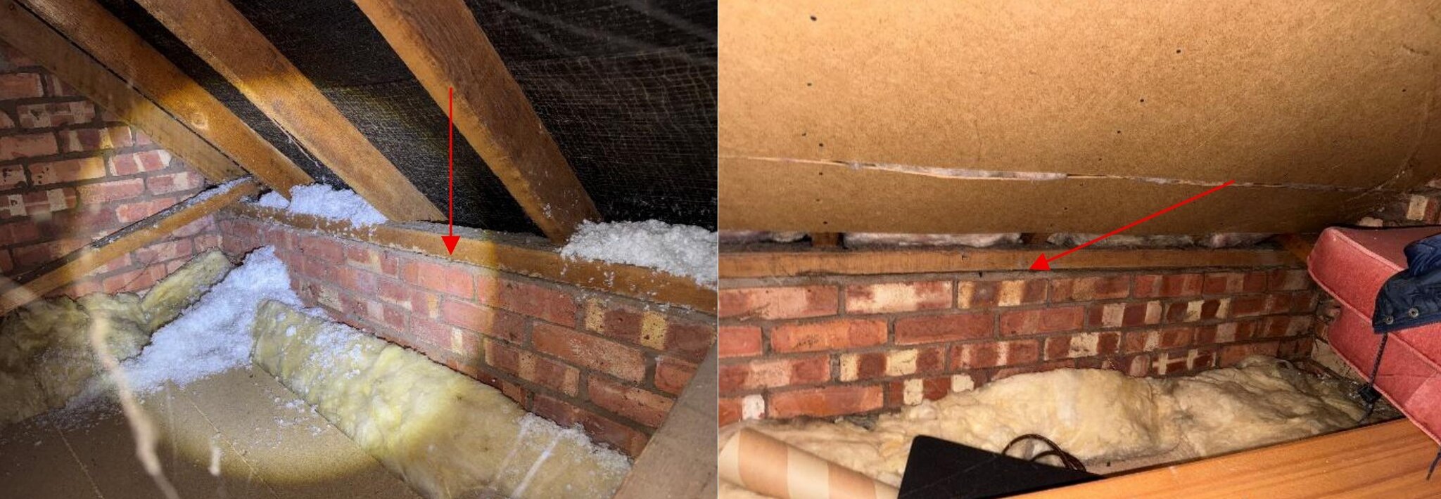

2. Slight wall plate movement
In the loft, the surveyor noted slight movement and localised lifting of the timber wall plates where they are bedded onto mortar.
They said the movement is minor and there are no signs of immediate structural distress, but recommended fitting galvanised restraint or holding-down straps as a preventative measure.
From the photos, does this look unusual for a roof of this age? Would you ask a structural engineer to specify the straps, or is this normally straightforward work for an experienced roofer or builder?

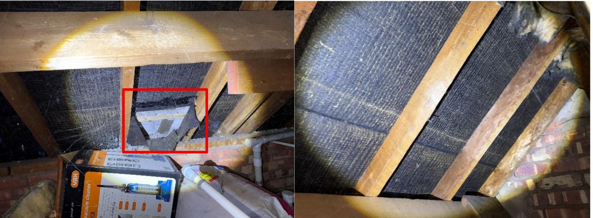

3. Local damage to roofing felt
There is a damaged section of the older black roofing felt in one part of the loft. The surveyor described the rest of the visible felt as generally serviceable and suggested a simple patch repair.
Can this be repaired properly from inside the loft, or should the tiles be lifted so the new patch can be lapped correctly from above?

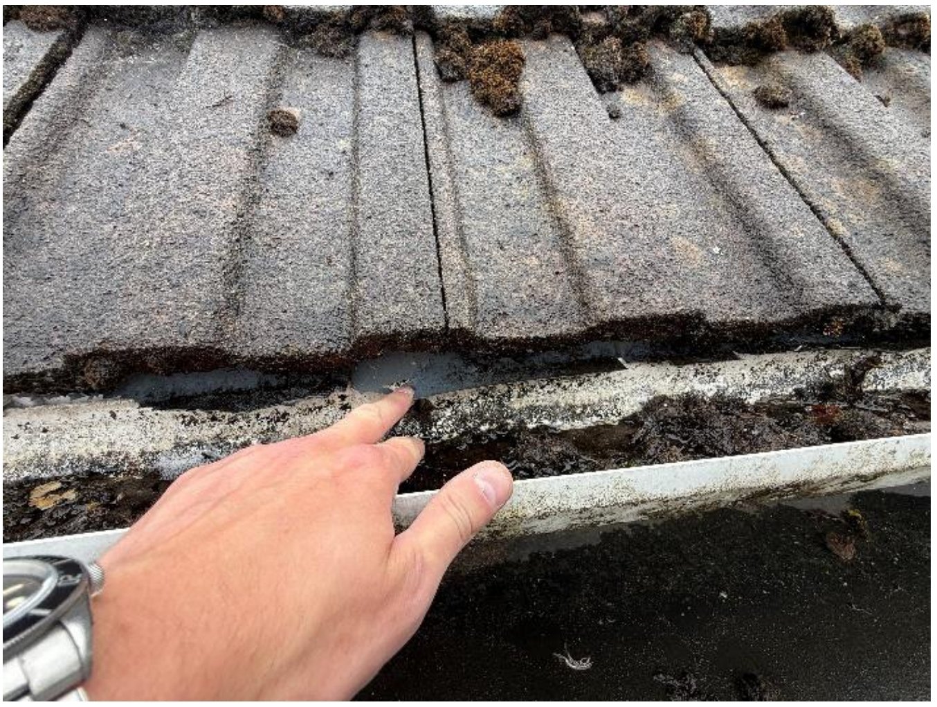

4. Plastic tray or membrane at the eaves
A plastic strip or tray is visible beneath the bottom row of tiles at gutter level. The surveyor thought it may have been installed as a previous repair where the original felt had deteriorated at the eaves.
There were no signs of active water penetration internally, but the detail was mostly concealed. Does this look like a normal proprietary eaves support tray, or an improvised repair?
Would lifting a few of the lower tiles be the best way to check that the original felt overlaps the tray and that it discharges correctly into the gutter?

Where is the roof (spread) restraint? I cant see any joists?
He's wondering about roof spread (do the rafters and the floor/ceiling joists form a triangle?).
Generally this would push the wall plate off the back of the wall and/or push the wall over (hard to tell from the pictures if this is the case) and the strapping suggested would do nothing.
Might be worth posting this separately on the building section.
As for the dormer generally, if it's a typical 70's build it's probably poorly built, with no insulation and ripe for replacement when you have the funds. The tiles under the flashing apron appear to be slipping down.
The insulation stuffed in the rafters and under that hardboard is potentially compromising ventilation of the roof timbers.
The roof itself seems to be at that age where many people chose to replace to reduce ongoing maintenance and improve aesthetics.
