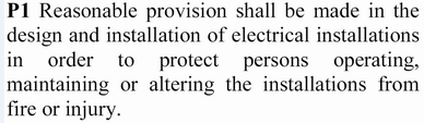

The only illegal thing I did was replace a consumer unit that had the case damaged by accident.
Not quite.
The only 'illegal' things were not telling the Local Building Control and
complying with this.
