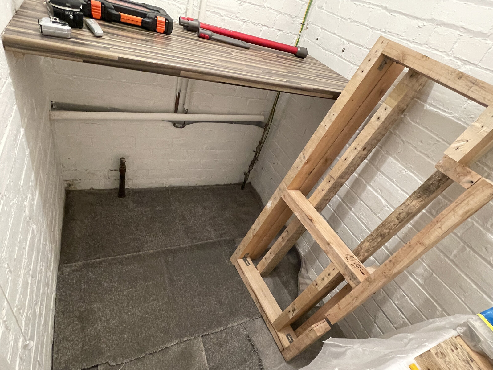

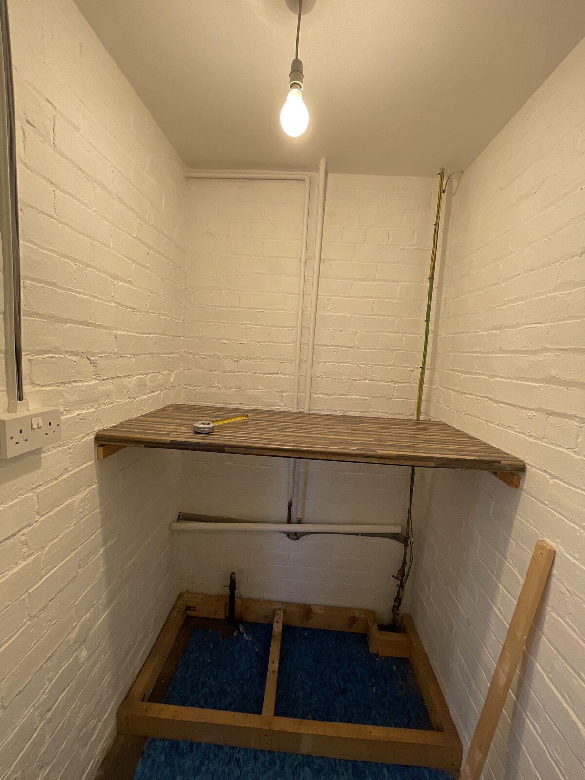

Hi,
I’ve got this really small utility room I’m building a diy riser in, to raise the washing machine up a little. The room has recently been carpeted and I’ve read online about being careful or cautious in case of any possible unforeseen leaks from the machine.
The carpet is underlaid and all glued down on to concrete floor and I’m wondering if I should put something over the carpet before laying down my wooden frame (riser) on top and fastening it to the brick walls? ….to protect the carpet from said leakage.
Would you do anything to protect here?
And if so, with what material? (Plastic dust sheet perhaps?)
The room is very cold, has no heating and I’m worried if I put a plastic layer over the top (or anything not breathable) it may accelerate or lead to carpet rot and mould that’s going to not be seen under & behind the riser. So questions, 1/ would you put anything down to protect the carpet under the riser frame? ..or 2/ would you put anything on top of the riser to protect and shield ‘it’ from any possible water/leaks that may reach it from the washer (or both?)
Linked photos show the room (ignore blue underlay in one shot), the silver carpet and wooden riser frame (mid-build). Seeking clarification re protections before I fasten it to the wall and finish it off. The top surface of the riser will be particle or ply board, painted with Dulux satinwood.
Sorry if I’ve not explained that particularly well. Any questions I’ll be happy to clarify of course. Thanks in advance for your advice

I think I'd ventilate the cavity
if the room has no heating, and contains a washing machine, I think it will get damp. I don't know if it has outside walls or any ventilation. You might add a small "pipe heater" which uses little electricity, mounted low down. I use one in my garage under some pipes, wired through an old fashioned room thermostat which has 15Amp contacts, I happened to have one (some of the modern electronic ones are 3A or less). I think it's a Drayton. I set it to 10C which is pretty cold, but well above freezing, and it will not turn on in summer. It gets no hotter than a teapot so will not start a fire. You can also get plug-in thermostats.

Thanks for that @JohnD I’ll look into it. Don’t suppose you have any advice for the wood & top surface protection do you mate? And you definitely wouldnt put anything down between the carpet and frame, no?
18mm ply, or a cut piece of kitchen worktop, perhaps. Not plain chipboard as water spillage damages it.
Can i just paint the ply once laid @JohnD ? Or will it need some kind of protection, coating etc? Was wanting to just do it white with satinwood. And no protection or anything to do to the frame itself? None of the walls are external by the way.

You can buy plastic drip trays for washing machines to sit in. As John suggests, that space will need ventilation, or the walls will rapidly suffer mould.
I don't think the drop trays will fit @Harry Bloomfield They're 70x70 from what I've seen and the riser is only 61 deep. Its been suggested I get a little pipe heater put in, but how would you suggest I ventilate? Doesn't all the heat and water get carried away through the exit pipe (which goes through 2 brick walls and into the drain outside)?

No, there will be some moisture escape, they are not fully sealed. I would want a fan in such a space, or leave a door or window open, to vent the moisture.
The room leads out to a 1.2m square hallway featuring the front door. Its pretty nippy down there (entrance to upper flat), so im guessing the air flow is reasonable due to poor insulation im guessing? And the door to the room with the washer in would be open 90% of the time anyway. Do you think this sounds okay, or still feel there's need for fans etc?

The smaller the volume of the space and the colder the walls, the more likely that moisture will condense on those cold surfaces. You could always suck it and see how it worked out in practice, maybe add a fan if you found it needed one to combat the moisture.
You easily could botch something, if it might be a concern. Timber battens surrounding the base of the machine, with some heavy duty plastic sheet laid on top, under the machine. You can even buy machine leakage alarms to warn you of wet under a machine.
