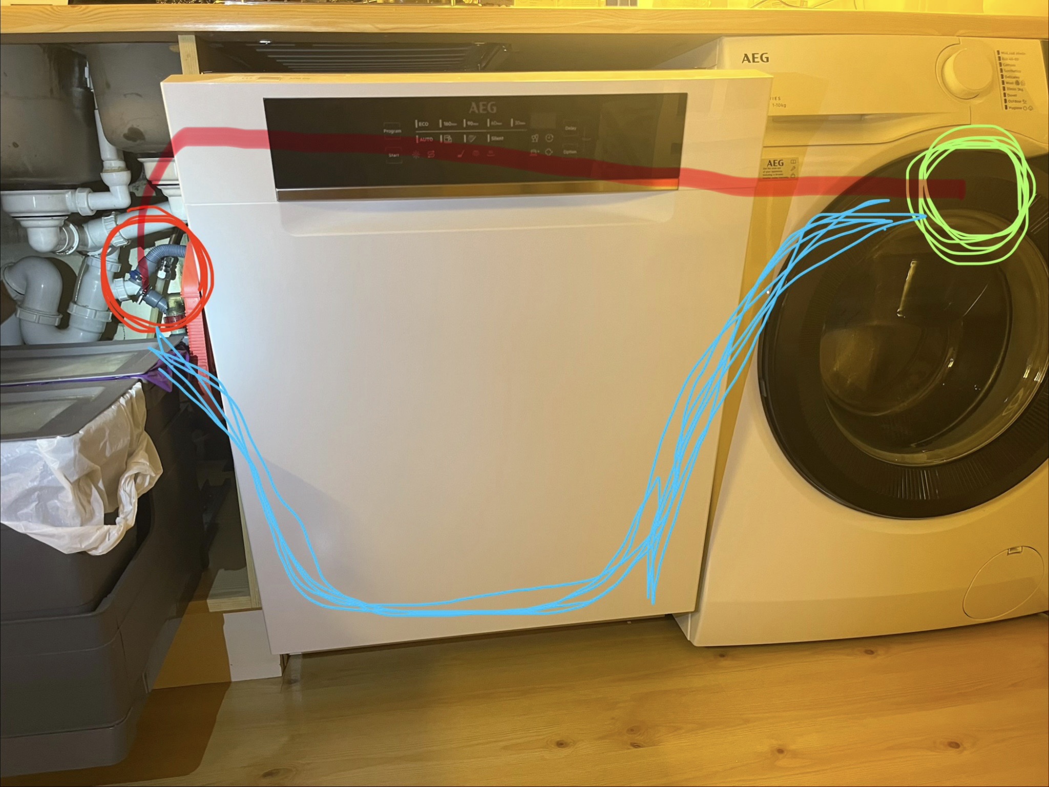

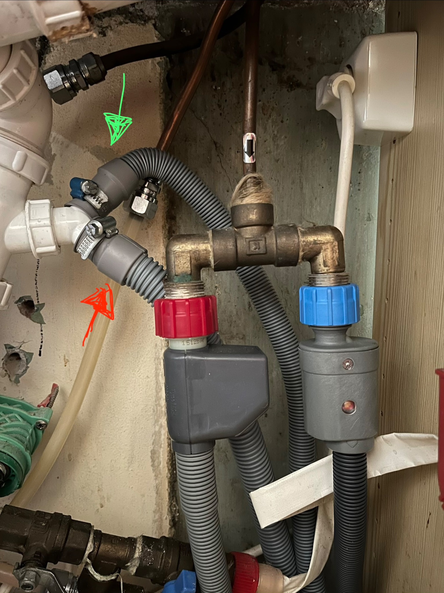

Connected up our new AEG 6000 washing machine and before I'd turned it on noticed that the drum was filling up with sink drain water.. Everything was connected up but then realised that I'd taken the drain tube off its last rear clip to enable the tube to reach the drain spigot. This apparently is a bad thing as the drain tube needs to be secured vertically up for gravity to stop water coming in?
This now means that the tube is not long enough to reach the sink spigot. Now looking into extending the drain tube.
Could someone here tell me if I'm on the right track? And if this is normal? I'm reading stuff like the drain tube can't be too long because of pump pressure. But it's not like the washing machine is that far from the spigot, it's only another appliance length. This is causing a huge amount of fuss and myself and my wife are going nuts.
Any advice really appreciated!
You can run it horizontally a bit and the hose clips should be removed. Sounds like a dodgy connection to the drain, got any pics?
@denso13 Thanks for the reply. The red arrow is the washing machine's drain pipe. The green arrow is the dishwasher drain pipe. The blue connector is the water outlet tube into the washing machine. The red connector is the water outlet one into the dishwasher. Everything seems sealed correctly. And I checked the twin drainage spigot for blockages.

Washer drain pipes, always need to rise up, almost to the height of the machine, before dropping back down to the drain. There are two reasons for this - so the wash water stays in the appliance, until the machine decides to pump it out, and to prevent dirty water flowing back into the machine, from other sources. If necessary, you can buy drain pipe extensions, but the above rule must be followed.
You really want it to loop up then back down into the drain connection, like the dishwasher, although more than that, preferably. You can get hose extensions which should help you out.

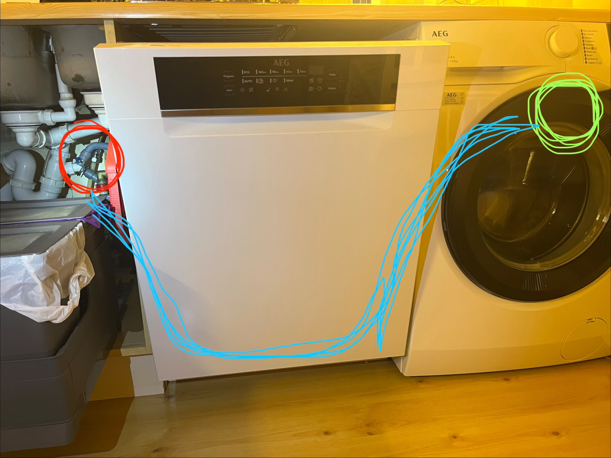

@Harry Bloomfield Thanks for the reply. Here's a photo of the appliances setup. Allowing for perspective I feel the top of the curve of the drain hose coming from the washing machine is slightly above where the end of it is inserted into the spigot?

No, up to the understanding of the sink and back down.
