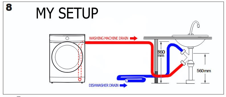

@Harry Bloomfield Thanks for the reply. Here's a photo of the appliances setup. Allowing for perspective I feel the top of the curve of the drain hose coming from the washing machine is slightly above where the end of it is inserted into the spigot?
As per Foxhole, the pipe needs to take the red route. At the moment, your hose is somewhat lower than the undersink trap, so the sink is initially draining towards the washer.

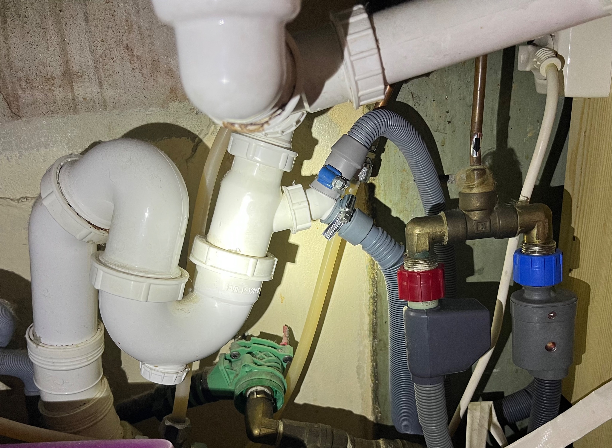

I thought I'd update as we've since experienced the drain water coming through again! Only once, but it's enough to make me wary something is still not right. We're also experiencing oddities with the machine's spin/drain function working only intermittently. In case this is also related to the drain, I thought I should investigate more.

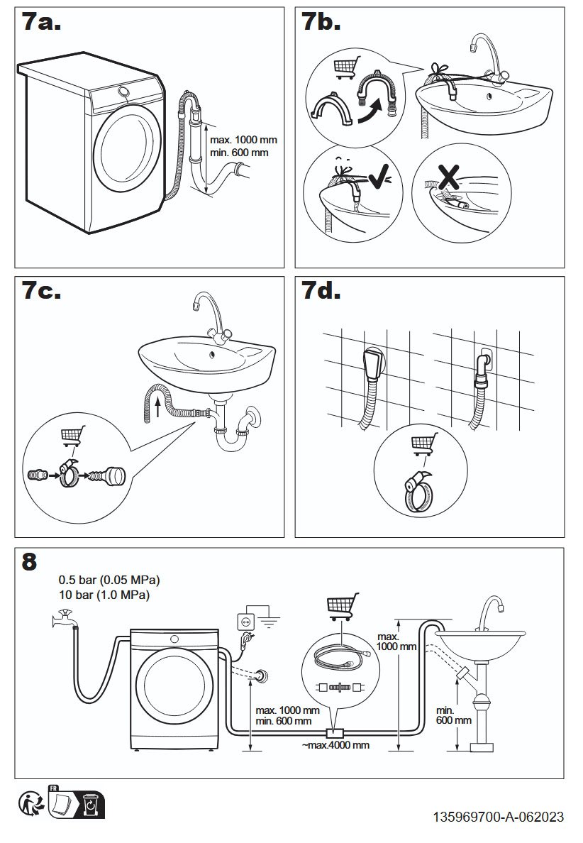

I've attached the page from the manual which describes the proper setup of the machine according to AEG. The other image is how I've got the hoses setup currently.

Can you take a photo of your connections below the sink now?
In your second diagram you need to come up from the connection, not down.
Still going down, you need to turn the connection to horizontal so both the WM and DW hoses rise immediately up, to the underside of the worktop preferably, then they can drop again.
@denso13 Won't that mean that there's very little difference/change with the washing machine's (red in my diagram) hose? As in the flow of the sink drain water will still be drawn down the hoses very easily? And the washing machine hose already raises up immediately.
Try this, it has to go up from the waste connection. I wouldn't have ran it so high along horizontally, but there you go.
Thanks for that @denso13 I only hoisted up the hose because of the advice so far. It's interesting to note that in AEGs manual I posted, they have the hose running along the ground and then up. I'll look into doing what you say but it will necessitate me creating a hole through the kitchen top side wall.

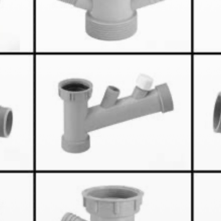

Looking at all the advice so far it seems that the sink drain Y connector itself is the issue. The fact that one of the spigots is pointing down and hence giving free flow access to waste water seems a bad idea. Then adding further contortions to the hoses could be causing the washing machine pump issues in clearing water out?
What I feel I need is a sink drain connectir where both spigots point up? Like this photo I found. Does anyone know what they are called? Adding in @foxhole and @Harry Bloomfield in case they know?
Quite, and why I advised what I did.
