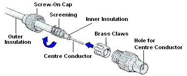

How have you taken cable around the room ?
Sounds like you have a bad coax connector issue ?
Remake both coax connectors at each end
Is it a cheap lead with minimal screening? Does it run past anything electrical which could create interference?
Check coax connector

Hi,
The cable has pre-made ends and it's not especially cheap, though by no means to of the range. It doesn't directly run past any electrical cables although there is a power cable buried in the wall that it must cross at least once. I'm not sure exactly where that is as we had the extension built 15 years ago and I made a mental note where the electrician had run them but don't exactly recall.
I've run the cable along the skirting board, under a radiator, up the wall, along the ceiling (conservatory roof) then back down another wall. Held in place with cable clips.
Is there an easy way to test fit interference?
Not withstanding the issue of interference because of poor screening, and presuming you haven't changed to the analogue tuner by mistake; then if your cable is neatly fitted around the room and that includes it being tucked in and/or around corners then there's a good chance that it is kinked or crushed. You'll still get continuity, but when a cable is bent at a sharp angle it squashed the insulation that sits between the core and the shielding. It's a bit like snapping off a chunk of the aerial on a portable radio. You might still get some stations, but not all, and maybe nothing at all.
My money is on interference first and then crushing/kinking second. In both cases the answer is to replace the cable with something decent: Webro WF100 or WF65 if you want something easier to hide. If a cable you first installed (regardless of price) isn't up to the job then trying to resurrect it is like flogging a dead horse.
Thanks for your advice. I've ordered a reel of the WF100 and will refit with that
