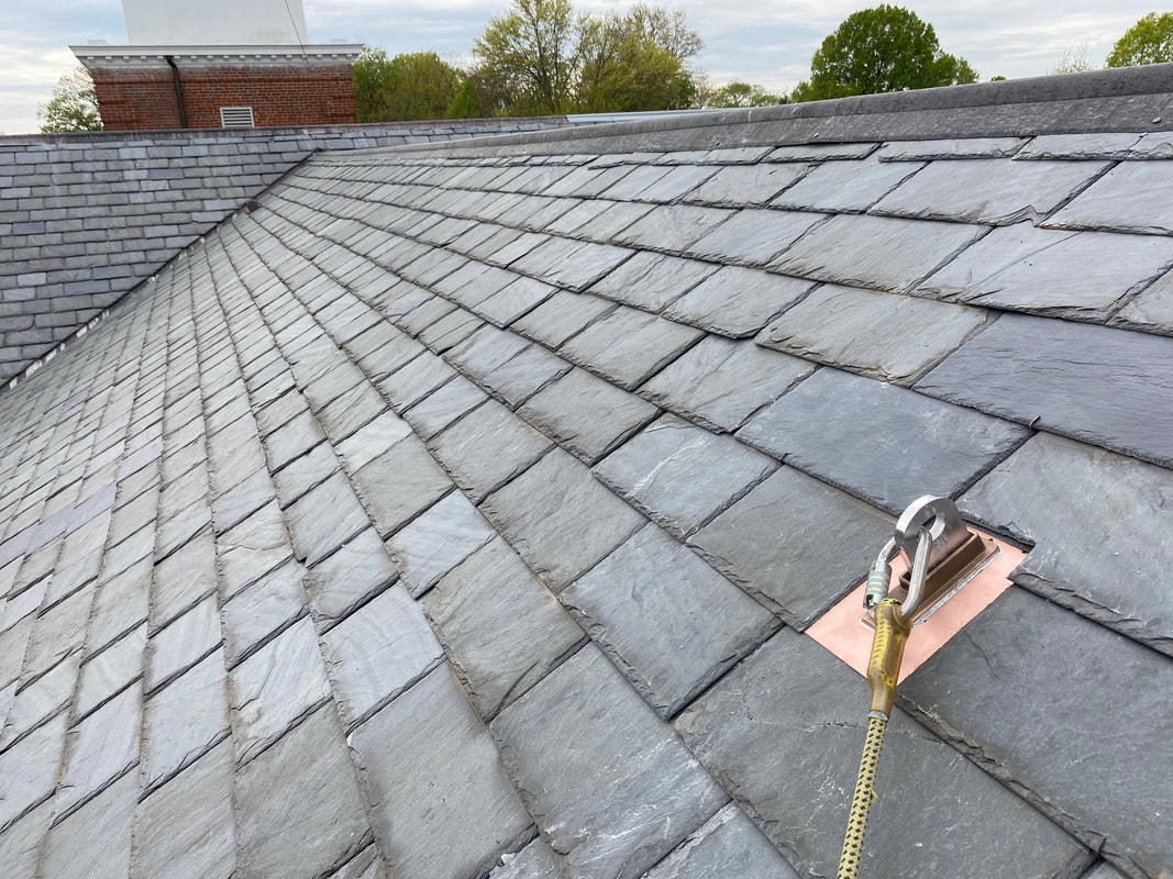

My roof is really steep and needs quite a bit of manual work done on it.
I've got a ladder with roof hooks but I'd prefer to be able to move around the roof more freely but would rather not slip and fall.
I already have a professional climbing harness and rope so I'm wondering if anyone has experience in using fall protection options like roof hooks?
Searching online most of the options are either extremely expensive or only available overseas.
For example this US product:
Anyone had experience with similar products in the UK, please?

A fall arrest system isn't the answer to work on a tiled roof. And if you think it is, perhaps you should not be attempting this type of work?
Nothing like that height, but working on my very slippy summerhouse roof, a couple of years ago, it was impossible without some aids. What I did was fixed screwed hooks along each side wall, lashed a rope through them, then took a second rope from that, up over the wall, and over the apex.

I absolutely agree that you'd need scaffolding for large jobs but I should have clarified I just need to do some ridge tiles and vents, not replace the whole thing.

He wasn't suggesting doing stupid stuff, he was discussing taking adequate precautions, to avoid the risk of a fall. Mountaineers, safely make use of climbing equipment, all the time, they never erect scaffolding.

Another possible option, depending on height, is to buy or rent a scaffold tower. Probably cheaper, as you're not paying people to put it up and take it down.
They are available up to some crazy heights, but you then need space for the outriggers that are needed for stability. Definitely don't even think about using one without, or putting it at any angle other than straight out. If you haven't got the space to do it then proper scaffold is the only sensible option.
I bought a used tower to replace my soffits and fascias (on a bungalow). Did all the job then sold it for more than I paid. Cost less than nothing.
I'd be reasonably happy to use a roof ladder off a decent sized scaffold tower. Just don't move out sideways, always work where you're hopefully going to fall back onto it. Not sure though, it would depend how high and steep the pitch was. Don't risk death to save a few £100s.
