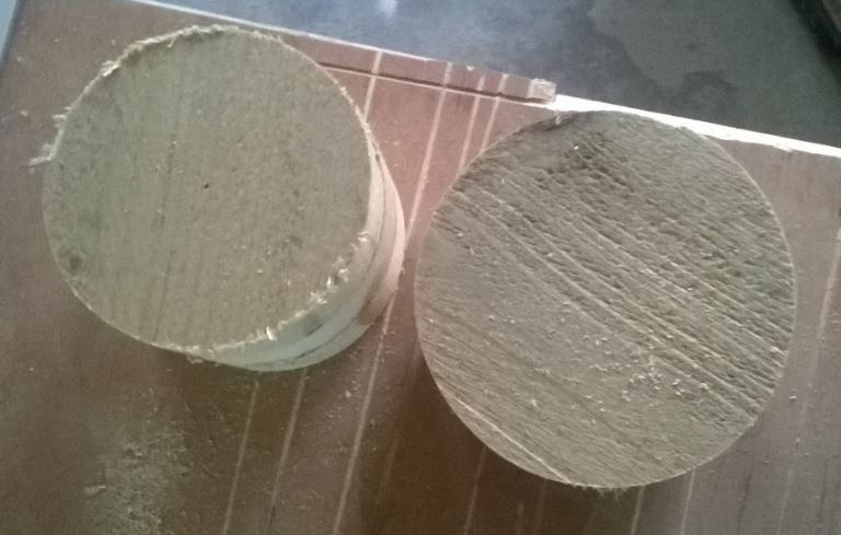

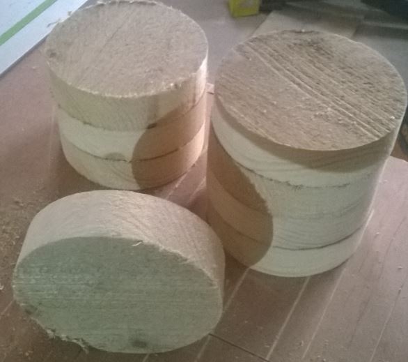

When choosing the P1cc I was undecided between going for the Festool and the Mafell for quite some time, having already concluded that the Bosch GST160BCE wasn't for me. I'm happy with my purchase. To put it in perspective, these may explain one reason why:
Those are 135mm diameter circular "pads" cut out of a 38mm thick scaffolding board with a P1cc and fence/trammel point using a Bosch T244D blade. The sides are nearly perfectly square to the tops and they wiould happily roll across a bench top. Try doing that with any other jigsaw, including a Festool Carvex.
In general I use a cordless jigsaw on thinner stuff, such as plywood, where minor run-out doesn't matter. I have cut structurl tenons with the BJV180 in 5 x 2s using Bosch T344D blades with reasonable results and requiring only superficial cleaning-up - it's just that i can't do it consistently
