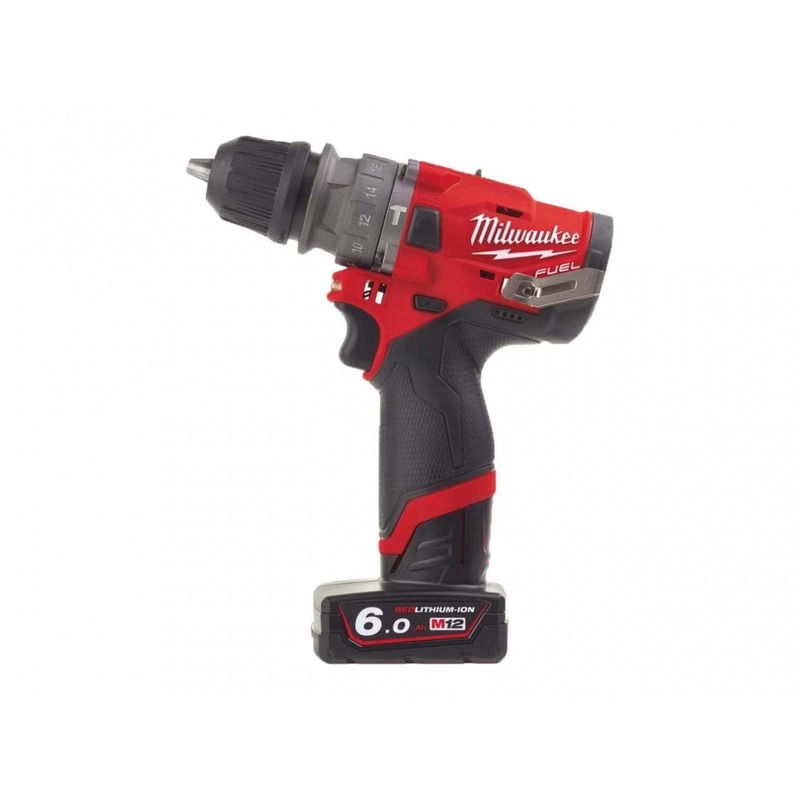

Milwaukee or Bosch? Small batteries
as opposed to the higher capacity ones:
I have a Milwaukee M12FPDXKIT with an M12JS and an M12FQID oil impact driver and I've been pleased with them, but they don't replace my Makita LXT 18 volt kit

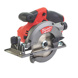

Similarly, whilst there are 12 volt saws around (for example Milwaukee do a really nice one)

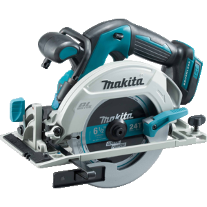

they are a bit more limited in capacity than an equivalent 18 volt saw such as the Makita DHS680:
with 44mm depth of cut (Milwaukee) vs. 57mm (Makita) at 90 degrees. Having had earlier brushed 18 volt cordless saws I'd point out that they are low powered and struggle on heavy cuts in comparison with the brushed models - they can cut 18mm plywood and 3 x 2 CLS, but you aren't going to be able to trim a 44mm fire door to length with one. I went from a Makita DSS610 (brushed) to a DHS680 (brushless) about 5 years ago and it was like night and day - much more oomph, made cuts the brushed tool would baulk at and is generally a far more useful tool. In budget terms, though, a corded saw still wins hands down as I could buy a "branded" 190mm corded saw for less dosh than a 165mm cordless would cost BARE (circa £150)

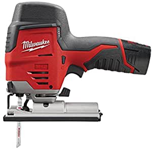

Finally cordless jigsaws are great. Again the brushless ones have far better run time (I went from a Makita DJV180 to a DJV181 - more because I wanted a body grip for doing scribes and my 180 was by then 7 or 8 years old) and a bit more capacity. One plus of the 18 volt ones over 12 volt ones like the Milkwaukee M12JS
is that the 18 bolt tools have variable orbit - the 12 volt ones don't seem have this feature, but they are a lot more compact and can get into far smaller spaces than their 18 volt cousins

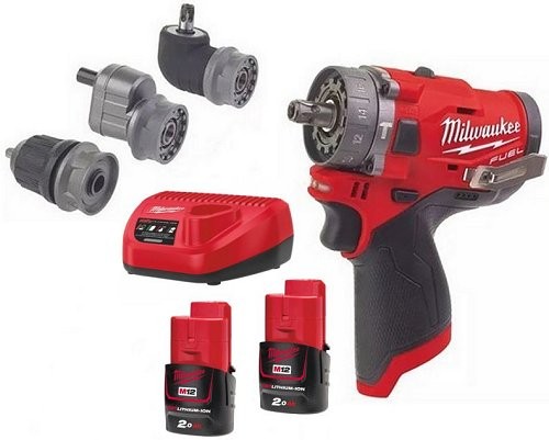

Comments based on my own experience of using Makita LXT 18 volt for about 12 or 13 years and Milwaukee M12 for 2 years. I have used equivalent Bosch 10.8 volt and DW 18 volt stuff and they seem just as competent, theyjusty didn't offer a brushless repleceable head drill when I bought my Milwaukee (nor an oil impact driver)
