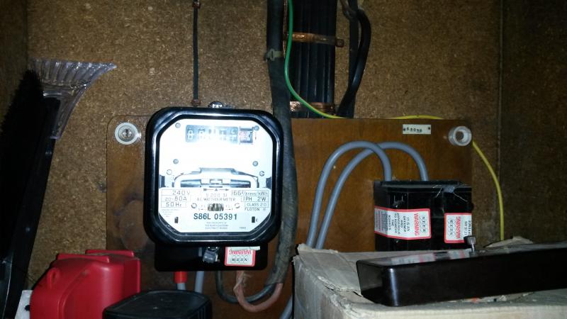

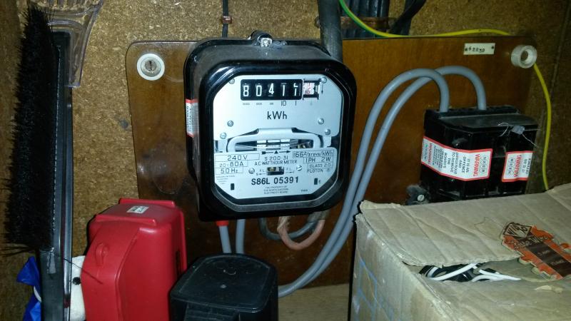

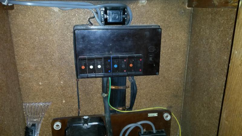

Hard to say, without a detailed look on site.
Are those cables PVC-covered?

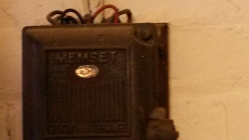

The last picture appears to show fabric covered rubber cables going into that MEMSET box (the insulation on those looks dodgy, by the way).
PVC cables started to be introduced in teh 1960s, so i would guess that some of it (the fabric covered bit) is probably about the same age as the house. The Wylex fuse board and associated wiring being newer - sometime in the swinging sixties.
But only a quick guess.
the memset box is in the garage and wylex in the house the cables in the house are black rubber cable and the garage is mostly in metal conduit it is old
Thanks again
Yes it's almost certainly original to the house, and well overdue to be completely replaced.
Yes , its well overdue an rewire , Though the Cables don't look too bad where they enter the Consumer Unit , You can guarantee that behind Switches & Sockets the insulation on the Cables will be perished , There is no RCD protection to any circuits as well.
Time to get the Pros in , then crack open the wallet !
Lucky
I would get an EICR done if I were you that will tell you the condition of the wiring, it will also tell you if you have an earth at that toggle light switch.
Rewire time. Don't waste money on any "upgrades" to this installation. It needs ripping out and starting again. I wouldn't be happy with anything else.
