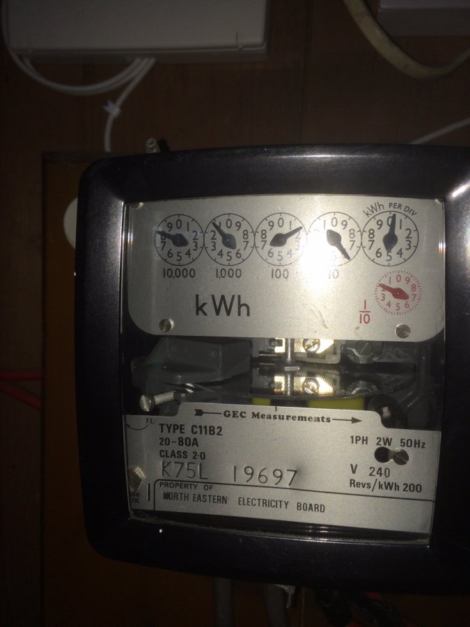

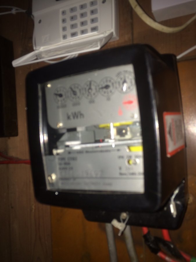

hi I don't suppose you know approximately how old this electricity meter is?
Thanks in advance

Repost the first picture, but in focus this time and I'll tell you exactly how old it is.
At a guess July 1969? Rob? :p
OP, AFAIK There is nothing wrong with an old meter, the supplier is required to ensure the calibration is less than 25 years old and to do this, they swap out meters as required, but removed ones can go back to to be re-cabibrated and re-installed somewhere else..... or rather they could and did... these days I think they prefer to install electronic ones and sadly these days they are probably not reused

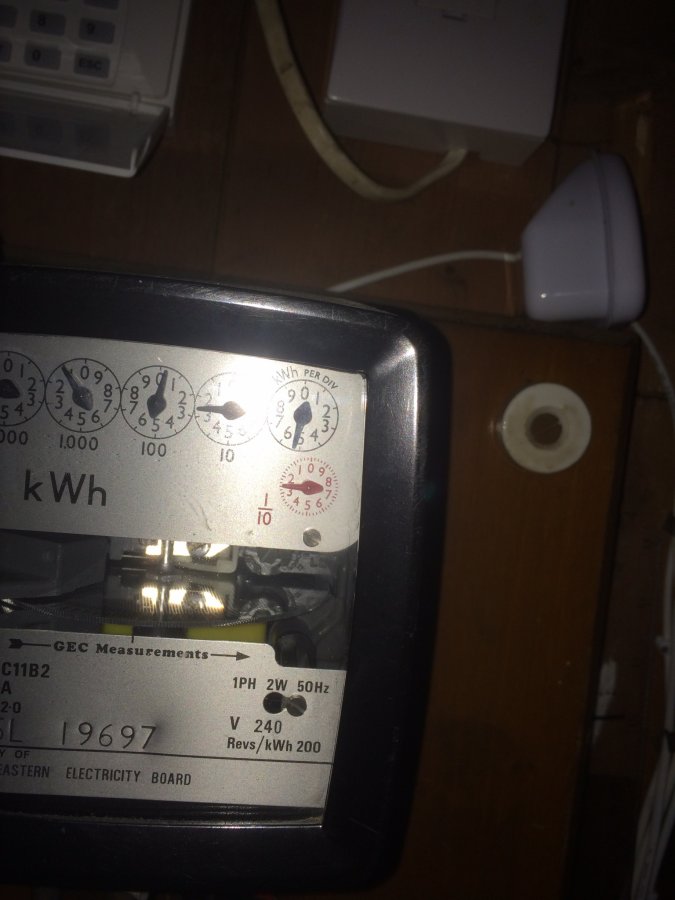

When that meter was made in 1975 the whole of Britain had only just about standardized on 240V nominal, and even then I'm not sure there might not have still been an odd place here and there on some other nominal declared voltage.
Ah, the 19697 figure was a red herring then!
Yes, that's part of the serial number.

Thanks for the replies it's older than I thought
Just wondering but what now then, do you want the meter changing or something?
If so then I don't think anyone would change a meter purely based upon its age!
