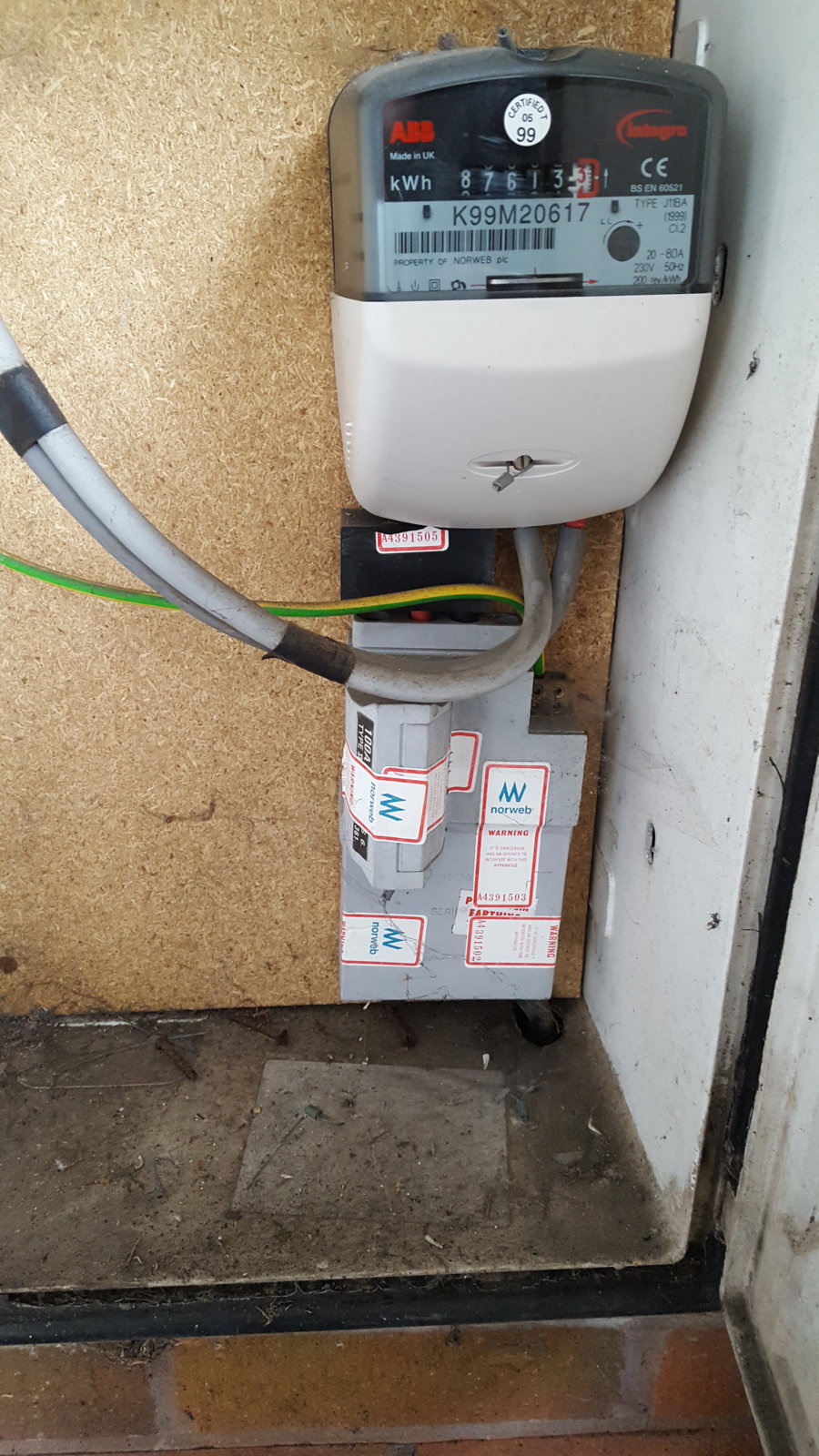

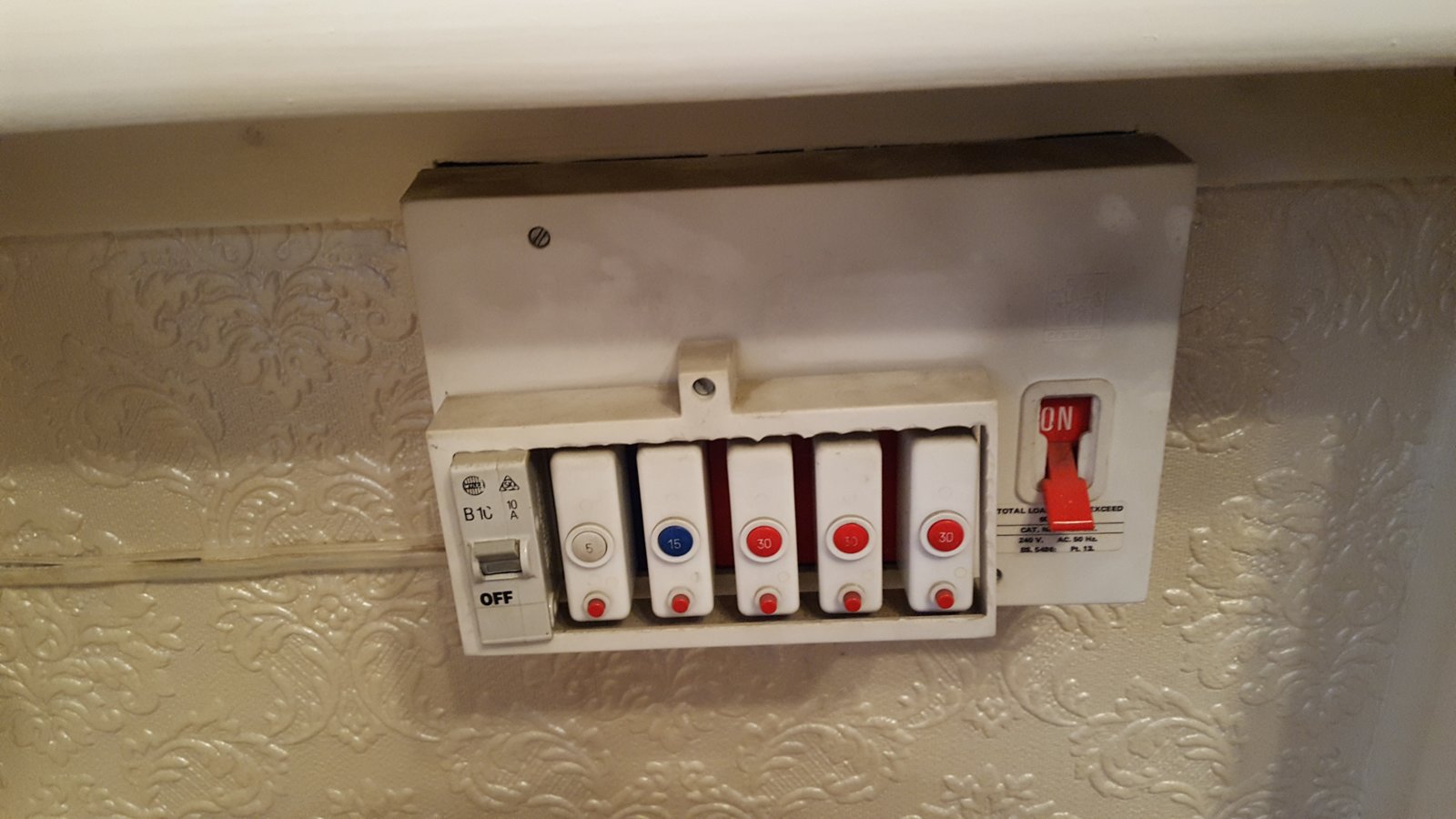

Hi please see enclosed pics.
We are buying a 1980s home and I am hoping we can get away with just having a new cu and partial rewire.
How old do you think the meter is and do you think tails and earthwire are the original ones?
Regards
That would seem reasonable. 1980s wiring, per se, should be fine for a good few more decades, but that CU could certainly do with 'upgrading'. How much rewiring would be needed really depends upon youir 'requirements' (in terms of additional sockets, cooker circuits etc. etc.
I would think that's probably a 21st century meter, but it's hard to tell more than that (it could have been installed 'yesterday') - but others might have more definitive ideas. The tails look as if they are probably a similar vintage - certainly OK for a long time to come.

ok ne,t question, do i need to get the elec board out when electrician installs new cu or can those seals be taken off by said electrician?:D
Also what earthing does the property have?
The general answer is that the DNO has to be called out to remove and then replace the service fuse. I believe that in some areas, some electricians have been given permission by the local DNO to break seals. In many other situations 'something else' appears to happen :)
I would think almost certainly TN-C-S ('PME'), but some joker has put 'Warning' labels over the sticker which says something about Earthing! In theory, if it is TN-C-S, there should be a label saying something about 'PME' ('Protective Multiple Earthing') somewhere around there.

I have a pair of similar fuse boxes in my house, both 4 fuse versions and both supplied from their own RCD, nothing wrong with them, other than to fit a RCD it would have to cover whole box so with a fault you have no power, because I have two boxes I can get away with it.
