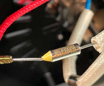

Thanks for your reply. The fuses are actually crimped to the wire, (pic attached) so I didn't take them out. Also from my previous experience of replacing one of them for the older fryer I mentioned, I was able to test using the multimeter with it in place (the same as the YouTube video I was following). In addition to that, I believe when the thermal fuse goes, it just dies completely, so I tested it more in the hope it would be a familiar fix.

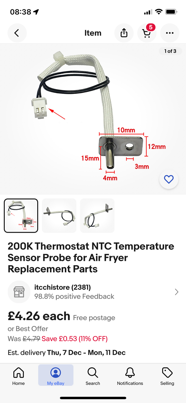

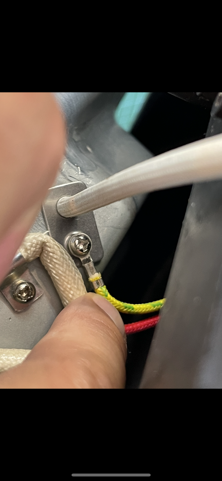

ive been asked, so thought I might post an update to potentially update others. I’ve fixed it and have been using it ever since! I replace the thermal sensor with a cheap eBay one from China and it fitted and worked fine. I even used the mounting plate it came with. (Picture attached of new sensor listing)
Conveniently, I also had another Gourmia air fryer to hand, so I originally transplanted the temp sensor to the defunct one for testing, and it came alive, confirming that it was the issue.

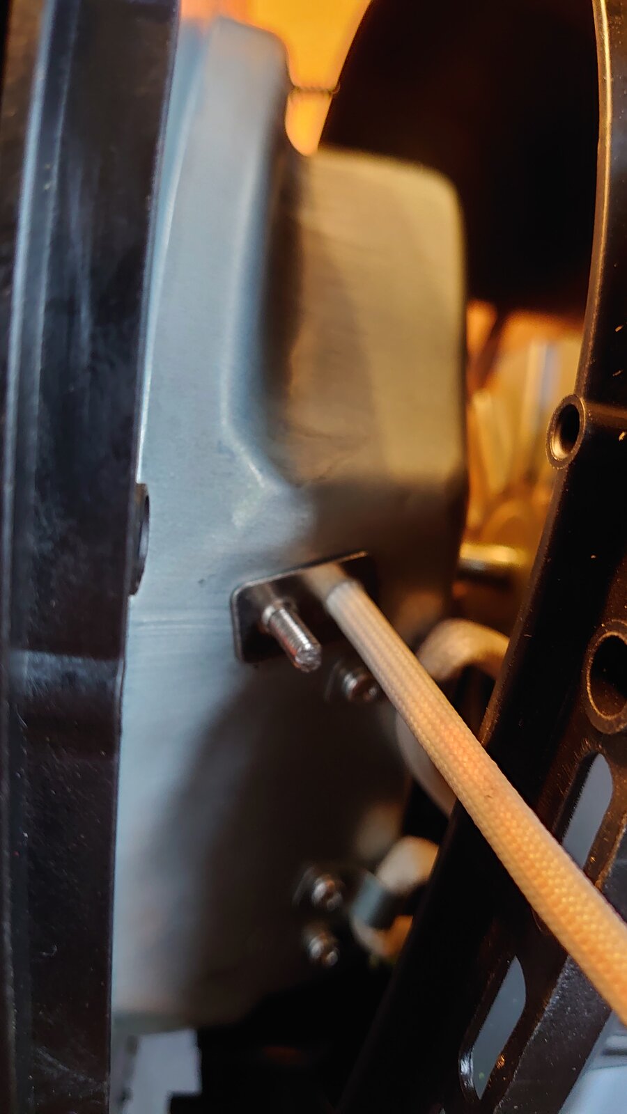

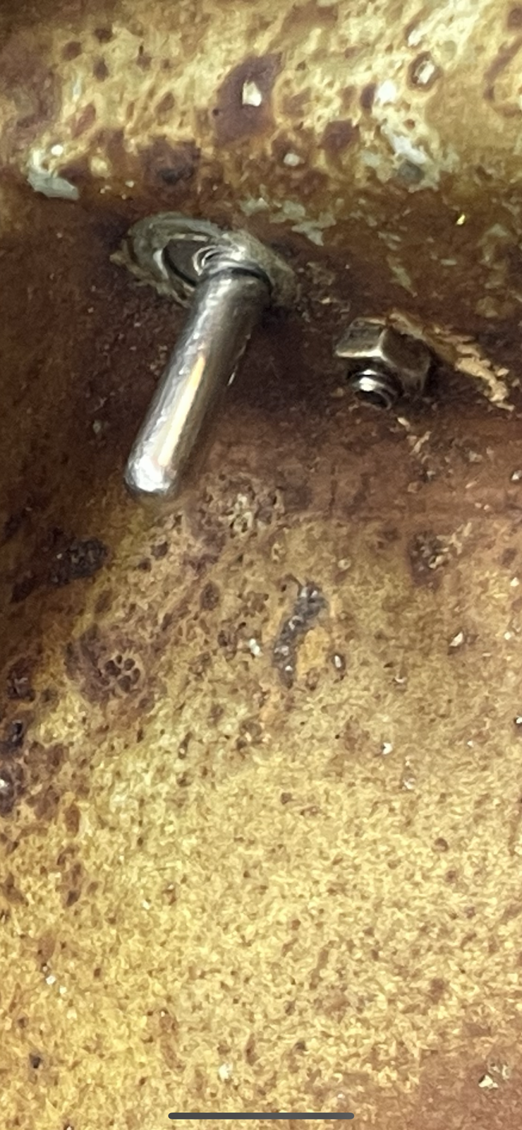

Additionally, the plate that the new sensor comes with, coincidentally lines up to an existing bolt/ hole. So no need to transplant sensor housings. Attached pic

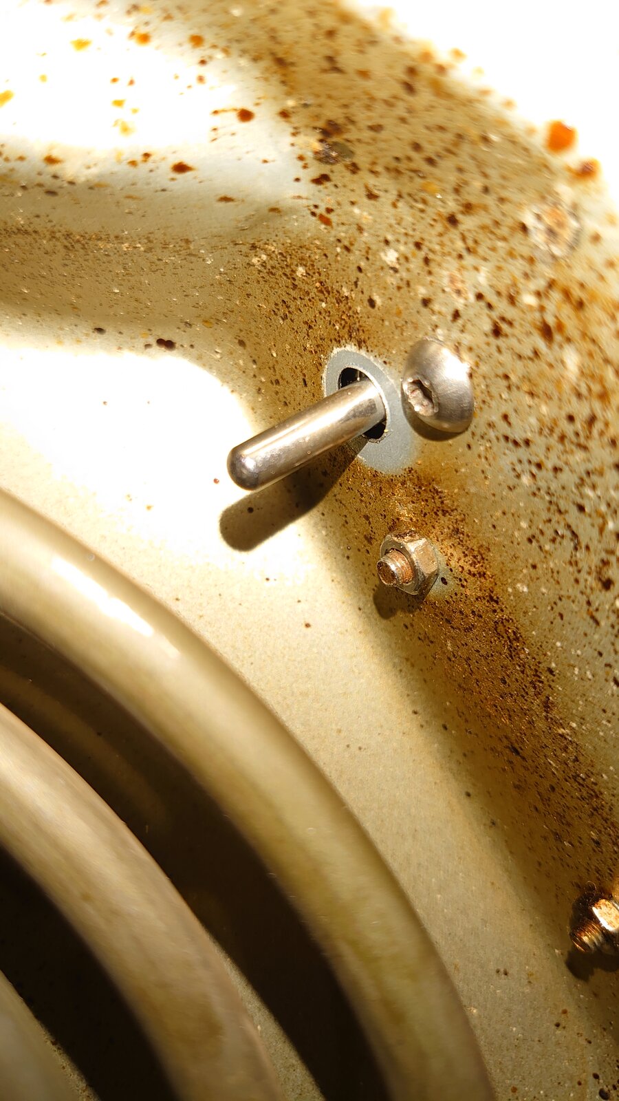

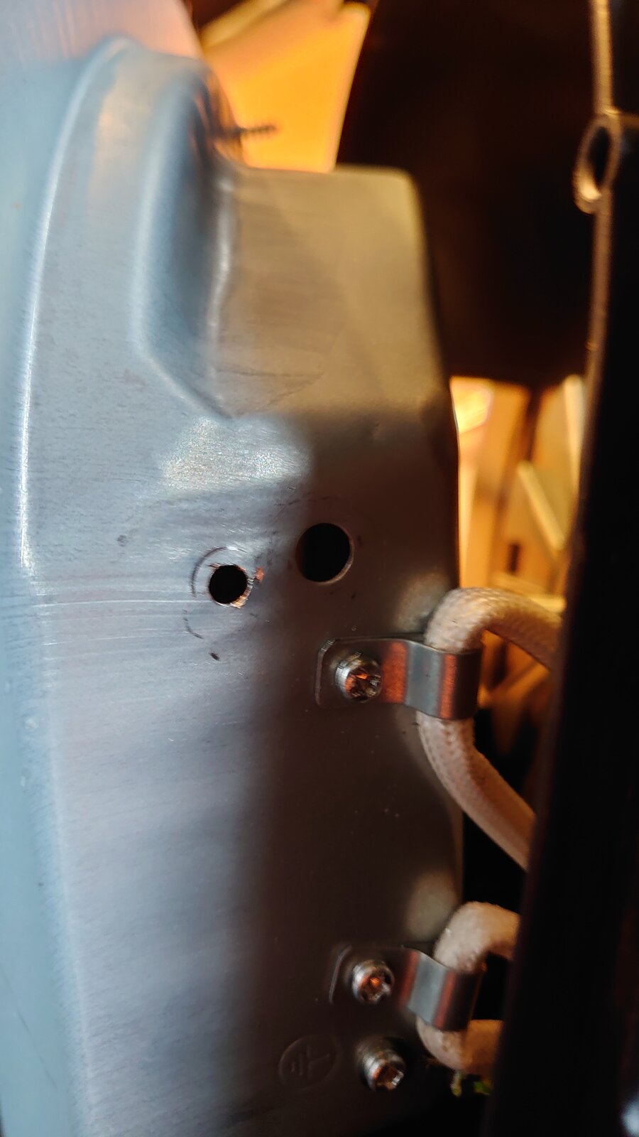

I think i have the same issue, E1 code. I removed the temperature probe and find no continuity across it. I assume it's therefore faulty. The probe has a black end which is a push fit into the metal bit that protrudes into the oven space lid. Did you fit your new probe into this same hole, and are you saying you also used an adjacent hole? Next to my probe hole is a small screw/nut. Is this hole that you used?
Apologies, I realised the pic of the fitted new sensor is likely to a different older model Gourmia Air Fryer. I completed this repair a while ago, so forgot. I transplanted the original Gourmet sensor from the older unit to the new one, and its worked fine. The new Chinese sensor with the plate fitted well into the older unit by conveniently securing via a bolt/ hole which was beside the sensor entry hole.
If I was to try to fit it to the newer model, then yes I would try the short screw to secure the plate. You can also replace the screw with a longer one, as I imagine its. regular screw.
Yes that’s the one. I think many sellers offer the same one. Yes the plug went straight in thankfully

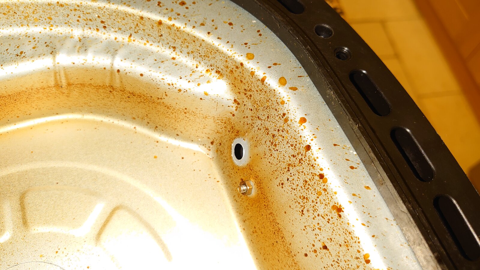

Update. My replacement sensor arrived from China, so have just fitted it. Not quite as easy as I'd expected. Getting the lid off without snapping the lugs is the first difficulty. I only snapped one, so it still fits tightly.
Getting access to the outside of the oven casing, to be able to remove and fit the new probe requires dissembly of much of the unit, including removal of the fan (note the nut has a left hand thread), but eventually i got there.
Unfortunately i couldn't use the existing cable screw hole (next to the probe) to secure the new probe, as Ardentstart did, as the hole spacing was wrong. But easy to drill a small hole in the metal to screw a stainless screw from inside the oven.
Seems to be working fine now.
