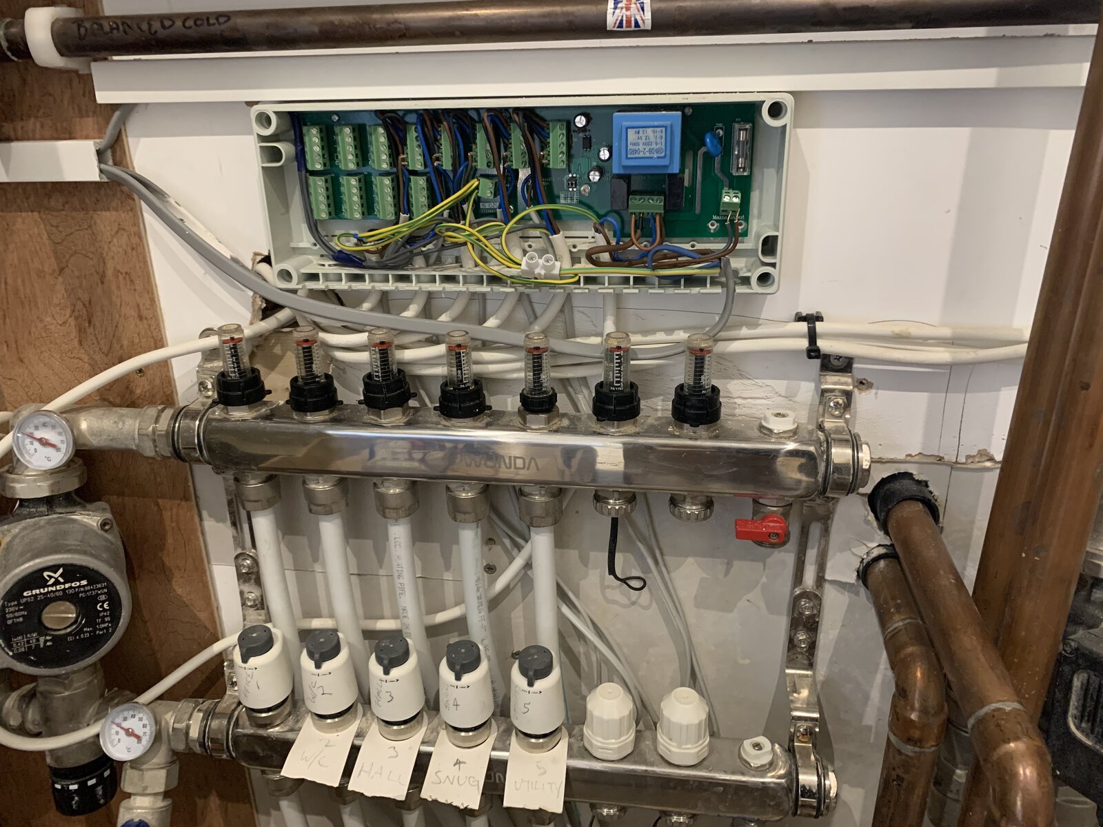

So I narrowed down the problem. It's due to an underfloor heating actuator -or- an underfloor heating pump. Here's what Ive done:
- There are 3 control boxes that power the ufh actuators & pumps, 2 downstairs and 1 upstairs.
- I disconnected power from them one by one and the 2nd box is where the problem is (attached pic)
- Since RCD trips on current leakage to ground I'm guessing a faulty actuator or pump makes sense, i.e. exposed coil makes contact with the water & leaks current?
If I feel adventurous I'll disconnect the power to the actuators one by one till I find the faulty one (somehow I'm convinced it's an actuator and not a pump) but at least I can turn the heating on now for the rest of the house and more importantly have some hot water! :)

My money is on the pump!
It's more likely to be the pump because the actuators only have live and neutral to them, they don't have an earth, so are unlikely to trip the RCD.

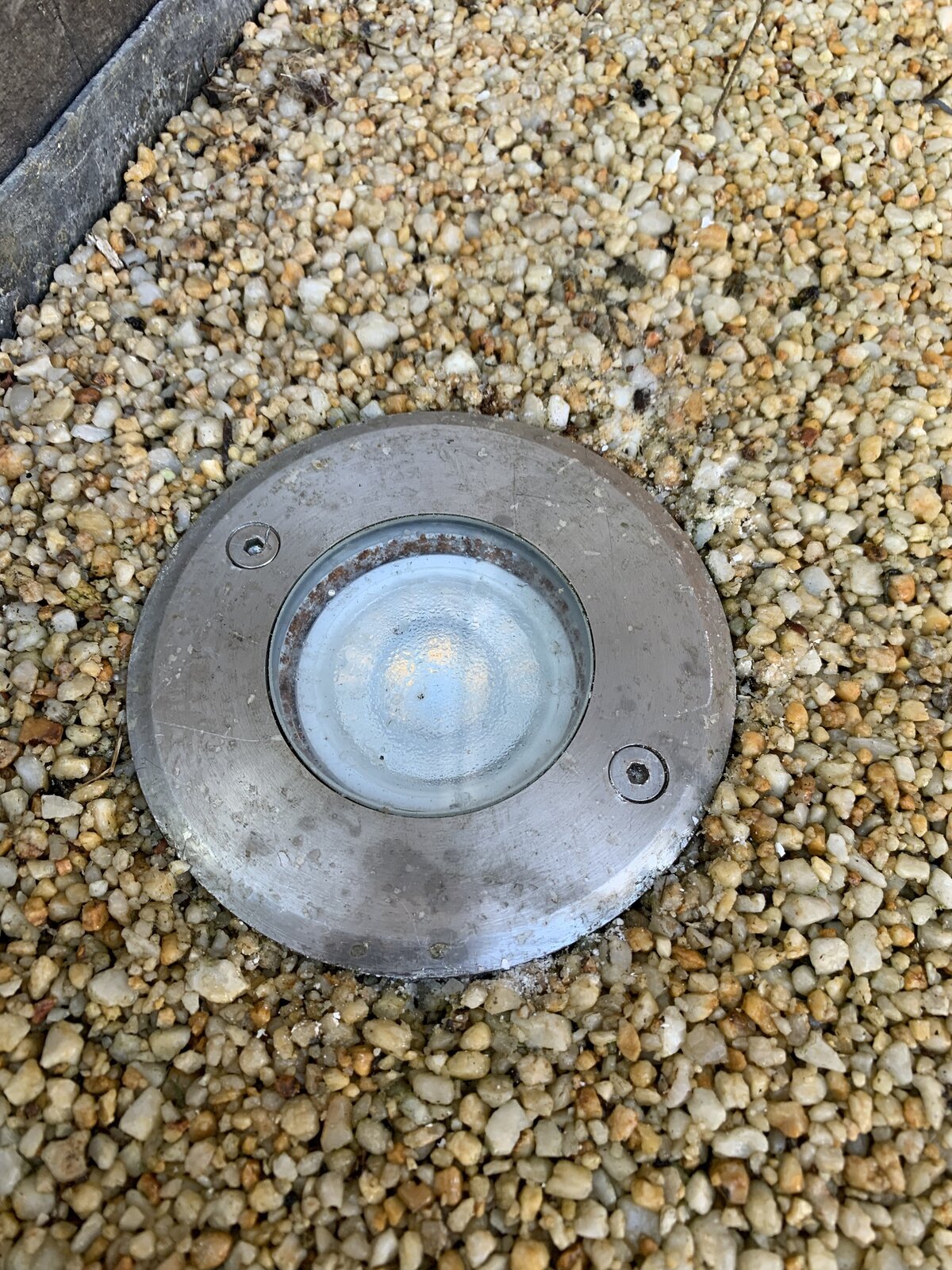

This is a follow-up..
I identified the light that caused the issue & isolated the circuit (there is no switch for the light, just an MCB and a PIR).
I know it sounds simple to replace a light, but this proved to be a pain, see photo attached.
It is a ground spotlight embedded in resin (!) and seems impossible to remove. I tried my best and was careful to remove all the stones/ resin round the edge (some of it was over the light cover).
I removed the screws but the cover itself seems stuck. I tried pulling, hammering and using a screwdriver as lever (and breaking it..) nothing worked.
Anyone has any ideas how to remove the cover or the whole light? By the way, it seems one of the cover bolts spins freely so the whole enclosure will probably need replacing. I suspect that was the cause of the leak.
Thank you!
