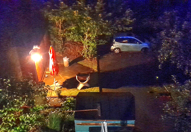

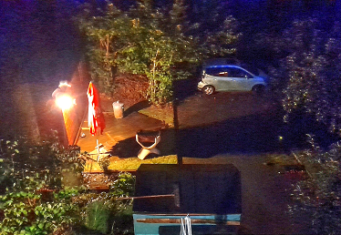

I note instructions do not show it fitted with an RCD plug. I have an outside light.
I want to be able to turn it on/off for the odd visitor to the back garden, so it is powered with a smart socket adaptor. So I can turn it on/off from house (voice command) or phone. Maybe something similar for the pump, it allows me to also set times, and is set to turn off at dawn, just in case I forget to turn it off.
I note instructions do not show it fitted with an RCD plug. I have an outside light.View attachment 407710 I want to be able to turn it on/off for the odd visitor to the back garden, so it is powered with a smart socket adaptor. So I can turn it on/off from house (voice command) or phone. Maybe something similar for the pump, it allows me to also set times, and is set to turn off at dawn, just in case I forget to turn it off.
I did look at this option, but I think the socket is borderline too far from the router to get a reliable connection and don’t want to open another can of worms
