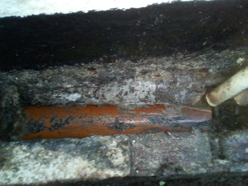

Hi,
I am cleaning up my bungalow following a rental period.
I think I have a problem with the drain.

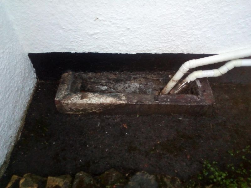

The kitchen sink and the washing machine are connected to the same drain outside right under the kitchen window. It is a 100 year old house so it is done the old fashion way, the 2 evacuation pipes reach an open drain with a grid, the drain being connected to the main sewage. See my photos.
Because of the grid, if the occupants of the house throw a lot of grease or rubbish in the kitchen sink, the grid gets covered and the open section of the drain fills up, overflows... It can be messy and occupants sometimes think that the drains are blocked when they are not, just the grid is dirty and does not let the water going further in the drain.

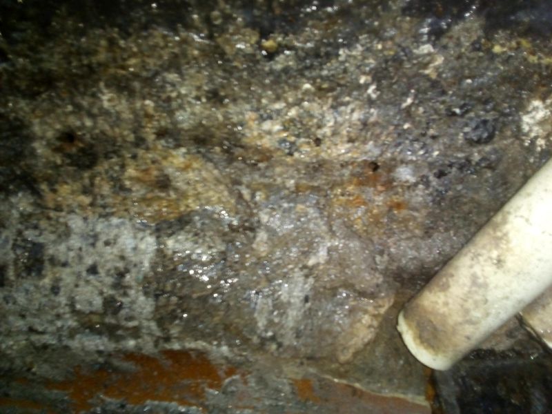

Cleaning that this week-end, I removed 2 buckets of grease of the drain and rubbing again the sides of the wall at that level, I saw 2 holes which are the holes of a metal air brick, in the drain (on photo3, 2 black holes over the white pipes, this is the bottom of an air brick almost invisible).
All that explains the funny smell in the house, specially the kitchen, I always thought it was smelling "old and mouldy" but normal in an old bungalow (we bought the bungalow only 3 years ago).
Anyway, I don't think that it is good as obviously dirty water leaks from the air brick under the house.
The air brick is positioned on the vertical back wall 3cm over the white pipes and maybe 15cms over the half clay pipe forming the drain, it must have been built like that. It shoudn't be a problem if people clean regularly the grid of the drain but if dirty water builds up in the open drain, than it leaks under the house.
How can I fix that? Is it common in old houses? Should we remove the metal air brick and replace by a normal brick? Should we apply a bit of cement or another product over the air brick to block it? What else could we do?
I will ask my husband to throw a bit of acid in the drain to clean and clear the all thing and maybe to show a better picture.
Thanks.
Letty

NO don't throw acids or strong stuff about ! Those 2 pipes need altering to discharge straight down into the gulley - chuck that grid away . You might get a plastic grid and cut holes for the pipes but it's not a necessity. The water going straight down will help clear the gulley. Jeyes Fluid is the stuff to splash around the gulley(y)

What about this air brick in the wall at the level of those plastic pipes exit, should I block it anyway? with what?
No, don’t block it. You need ventilation under the floors.
Follow the others’ advice about improving the drain, and then if necessary think about what to do with the air brick.

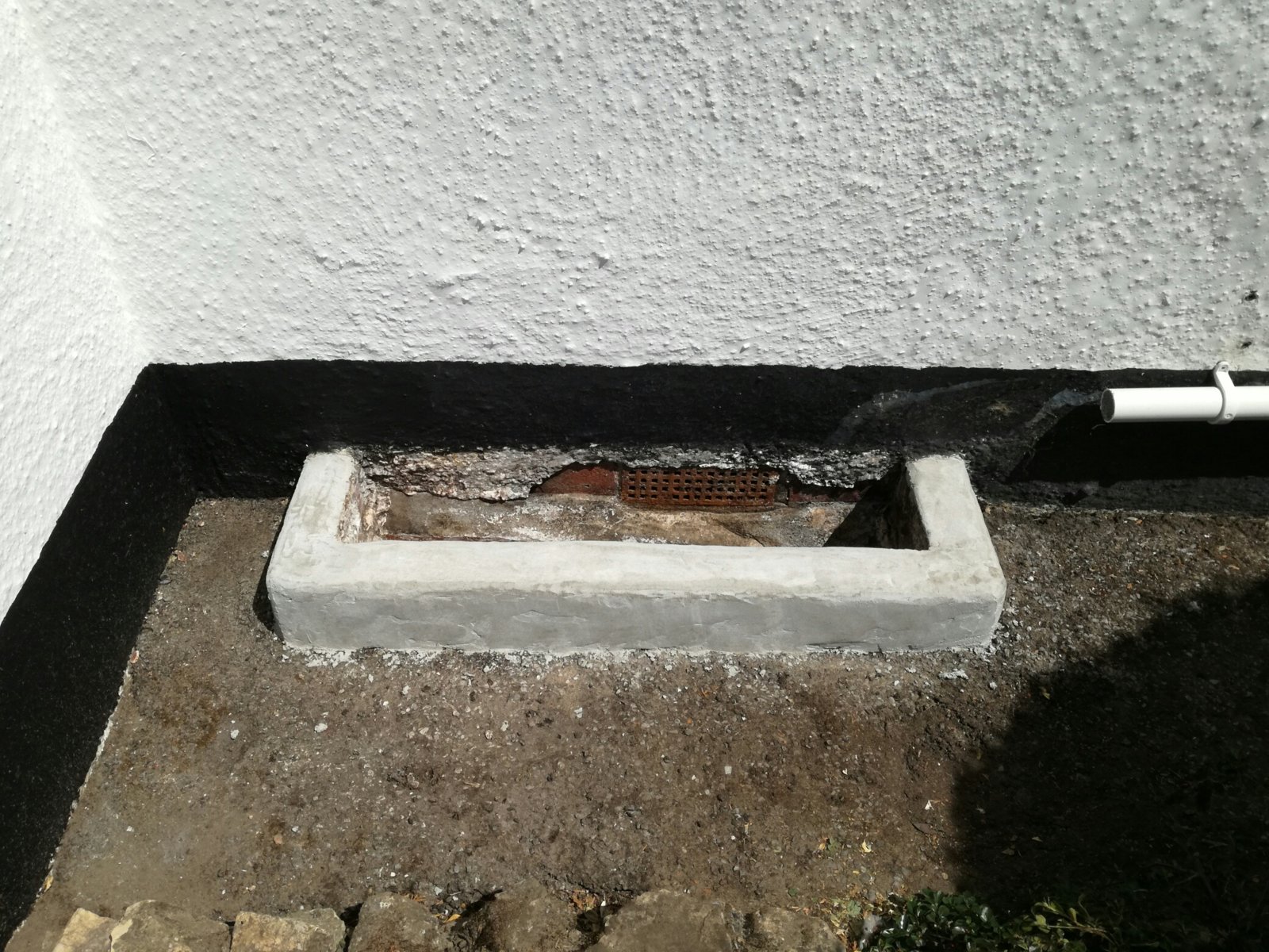

Hello,
I am in the process of improving the drain.
I have uncovered the air brick and will make nice around it.
As advised, I will re-organise the plastic waste pipes (will join the 2 in 1) and make it go through the gully grid to avoid any further flooding due to dirty grid.

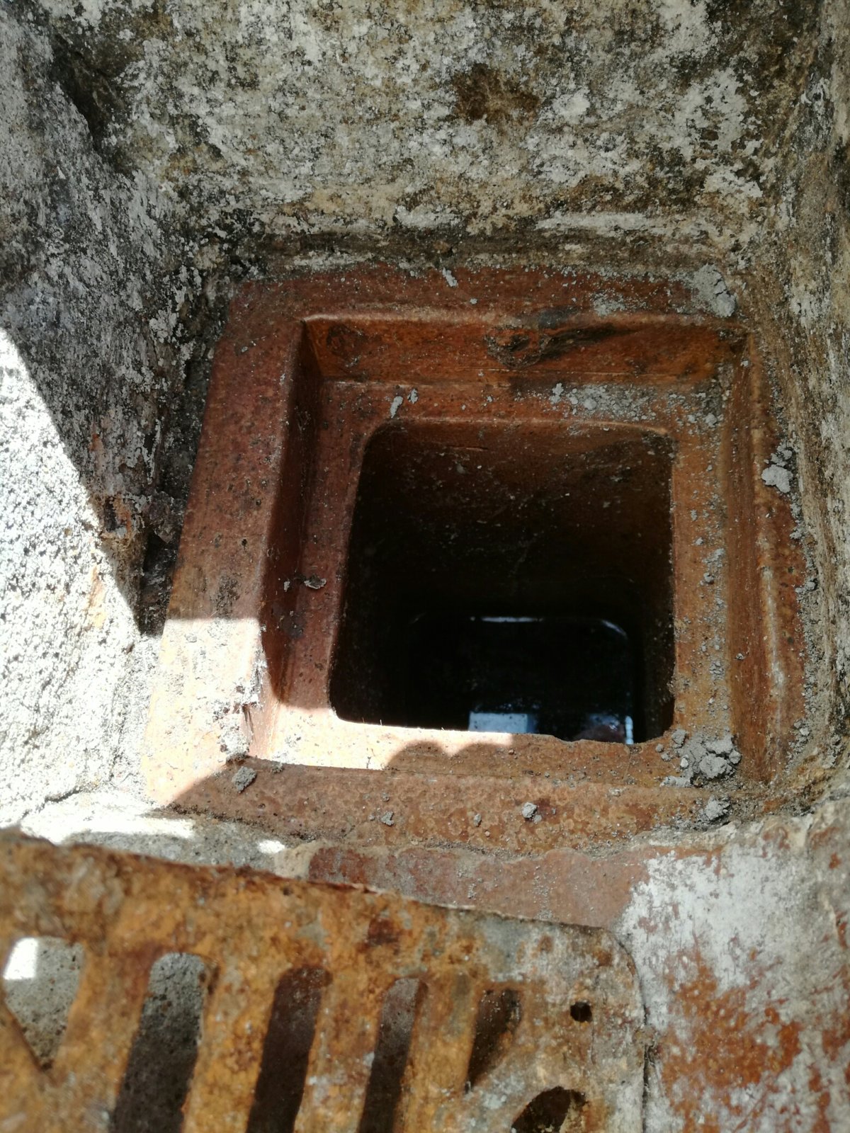

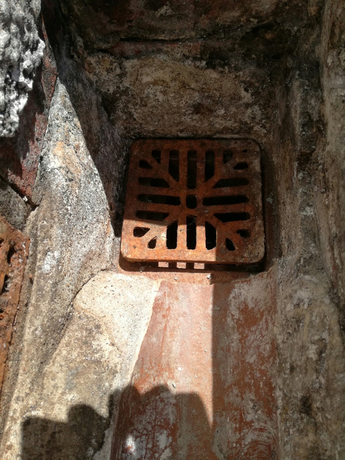

The grid is metal. It is very old and have a funny size, it is 5".
My problem is that I would need to replace it with a plastic one to be able to cut a hole in it but I cannot find anywhere that size in plastic.
150mm is too big. I could have a 110mm as there is a lip further down the hopper but I cannot find that size either.
Where can I find a 110mm grid please?
Shall I buy a 150mm a fiddle with it (won't be nice and I like when it is neat!)?

That airbrick isn't ideal where it is- as you have found with the musty smells coming into the place. I can't tell from your pics where the airbrick is in relation to the actual gulley- if the gulley is on the left of the drain thing & the airbrick is on the right then reudcing the size of the drain thing will help significantly.
You could put a periscope on the airbrick but it would look rubbish. You could duct it above the drain thing but again it would look rubbish.
If you have any access to the subfloor, putting a new airbrick in would be the best bet, you can then block that one up

No don't join the 2 into 1 - you will get one discharge pulling on the other pipe - keep them separate -or you will get smells because the traps are being "pulled". Plenty of room for 2 pipes to go down through the modified plastic grid. PS . Don't worry about bobasd and his comments - we finally got him banned ( and his 3 other aliases) (y)
