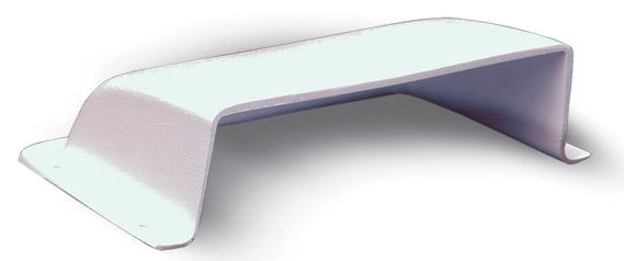

However, before spending out any money on extra parts, find out if this is going to work, or whether it is simply too much heat entering the loft in the first place(as @stem said about heat through the roof tiles) and you need more BTUs. Stack up some boxes or whatever you have under the loft hatch and put the unit on them, so that the top of the unit is as close as possible to just under the loft hatch. With cardboard and lots of sellotape, make a 'cowl vent' to deflect the cold air up into the loft. Imagine this, but pointing up...
That way, the loft will be under slightly 'positive pressure', which is what you want, to avoid the issues I explained earlier in the thread. Today would be ideal to test this out, it's bleeding hot already!!

I’m out and about today so may not be able to test that however if by having the unit outside of the loft then it’s not sucking up and venting the hot air from the loft, only blowing cold air in to the loft. I’m by far no expert but surely removing the hot air by exhausting it would be best?

No, because of what I said before about causing a 'negative pressure' zone in the loft, and just sucking even more hot air in to replace it.
Pushing out hot air with some cold under 'positive pressure' is better than pulling in more hot from elsewhere.

You want the coldest "source or intake" air you can get; let the unit do the heat exchange by cooling it further and blowing it up into the loft and then getting rid of the exhaust heat as easily and as far away from the source air and loft space as you can. Remember you're trying to do the best you can with this unit, which is likely underpowered and is trying to cool a space that is not thermally stable. It's fighting a losing battle and modifying as many of the parameters as you can will help it cope. :D

Regarding the test by putting the unit near the entry of the loft. Could I just position to vent so its pointing up and blowing into the loft (its got a swing vent that can set in one position so I should be able to send the air in to the loft whilst keeping the unit near but just outside..
As long as it blows "pretty much up", rather than sort of "up and outwards" at the same time. Sellotaping on some card to the unit and then taping the top edge of the card to the opening of the loft hatch isn't really going to be much bother or take up much time, though, is it.
