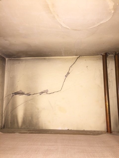

Hi all,
I moved into a 1960s house about 4 months ago and I have just noticed this crack in the airing cupboard (first time looking in there with it being empty) It looks old and there are no other cracks like it. The other side of the wall is a bedroom and again no cracks.
The plaster looks like the original.
Also a boiler has been installed pretty much directly above this wall so I assume the added weight might have caused this at some point.
Is this anything to worry about? or can I just fill it in and repaint?
Thanks,
More likely to have been caused by new notches in joists for the pipes than the boiler weight.
If it's historical just fill it in. If it's still moving you'll need to do something.
