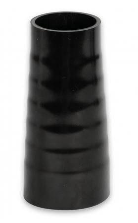

The chop saw would certainly benefit from dust extraction as will the circular saw. I'd say that the jigsaw is a lot more moot because they don't really generate that much dust on many jobs. In my environment (site carpentry) we use industrial vacuum cleaners which more or less all have a 35mm hose connector as standard - the Henry isn't to that standard, but firms such as Trend make tapered adaptors for all sorts of tools. they are not alone as this example (from Axminster Power Tool) shows:
It may be necessary to form some additional chute for your chop saw using zinc plate or aluminium to better direct the dust, but that's a matter of taste. The vacuum you have really doesn't have adequate filtration for wood dust, though (we use class M vacuums in wood working these days), but it could be improved considerably by adding a pre-filter cyclone such as the Oneida Dust Deputy or Triton model
