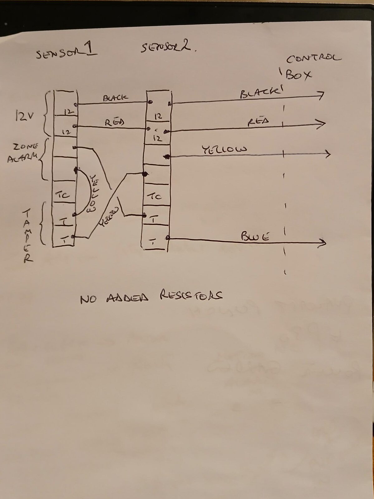

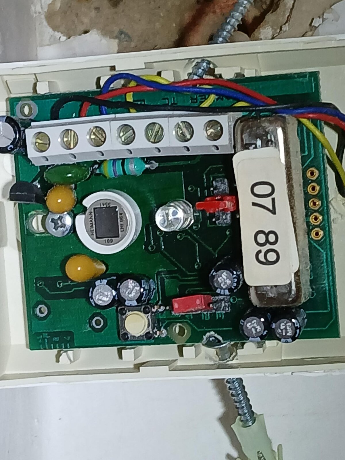

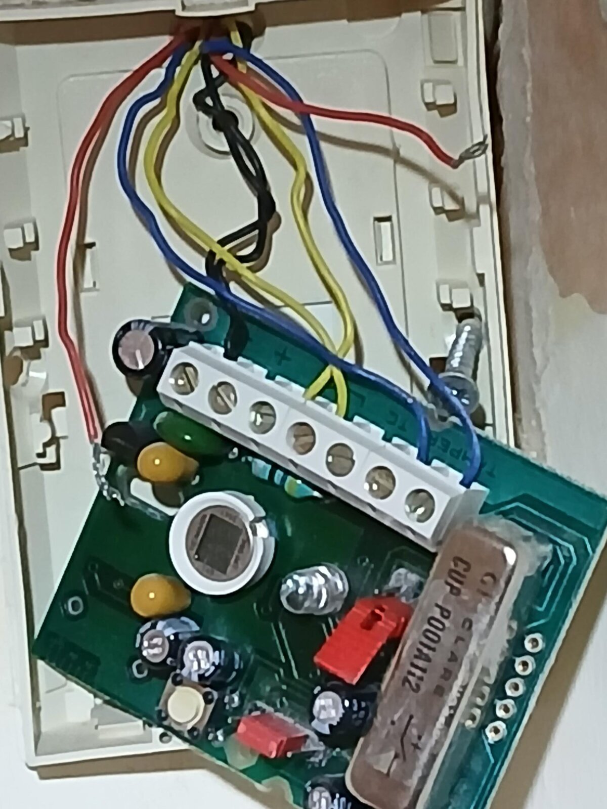

I had 2 failed old Elkron motion alarm sensors (4 core) wired in series as in pictures. They are in adjacent rooms connected through a wall with short cable. They worked well and did the job. I have 2 Texecom Capture P15s to replace. The control panel is Scantronic 9448+. There are no added resistors. Can I just wire these in the same way? Do I need to change the resistor setting inside one or both sensors if in series? Many thanks for any advice.

You’re not using resistors on that alarm panel ….set pir as normal alarm and tamper
Many thanks. Sorry to ask for a bit more information. For two P15 PIRs in series can I go; Control panel PIR1 alarm then PIR1 tamper to PIR2 alarm then PIR2 tamper to control panel? (And ignore resistor setting in PIR P15s)? That would be really helpful to know. John222
Great. Thanks. Just one other question. I presume this control panel will not be affected by the resistors in the PIR ie lower voltage with alarm off?
