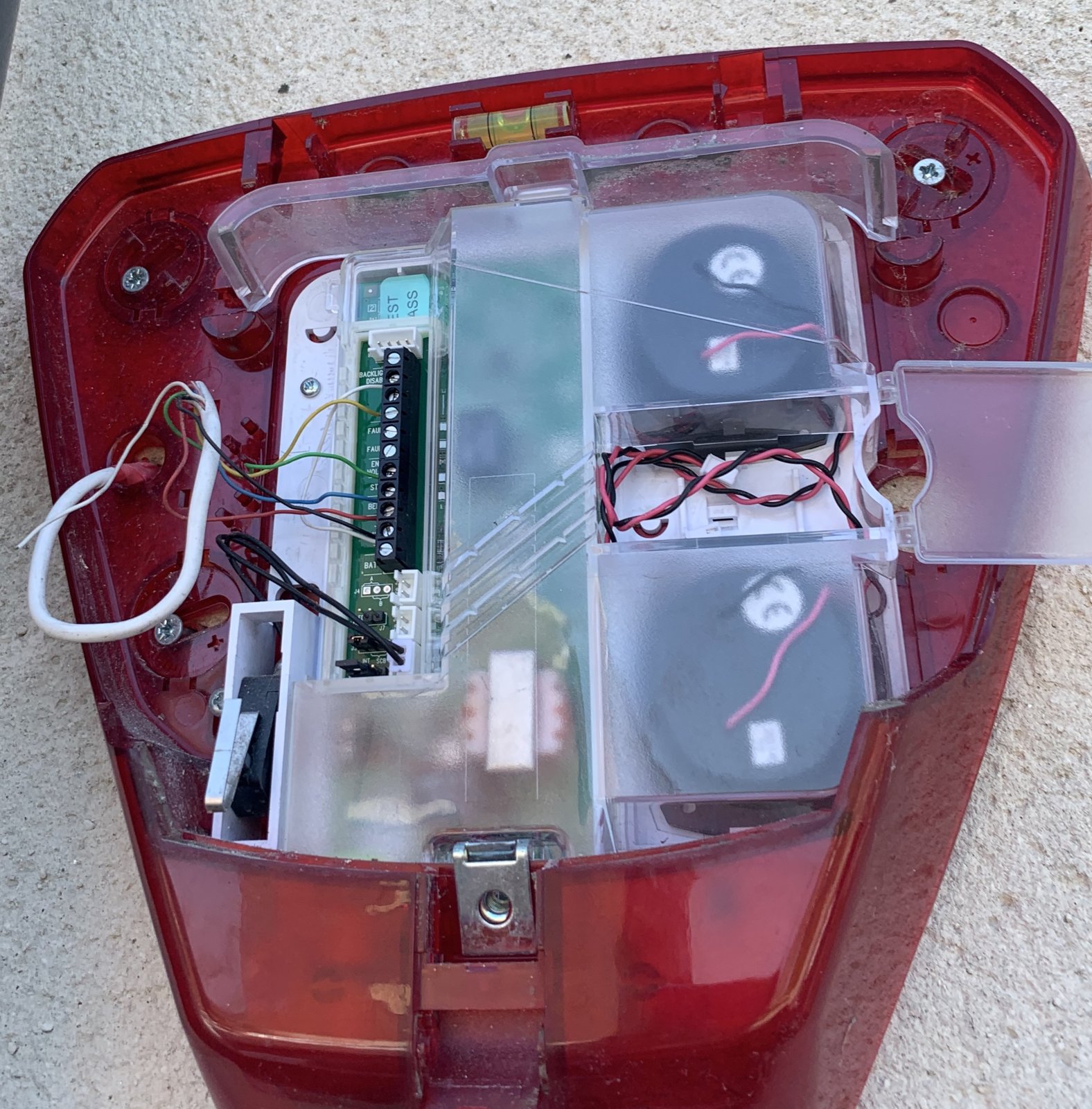

Just been up (shortish) ladder. It's a circuit board, had the 2 sounders plugged in so disconnected those for now.
All connections were secure. One thing noticed was where the cable comes out of wall into box, had leccy tape on. This is right where rain maybe could come down back.of box, poor install by a professional installer! Even if originally like that surely should have fixed that better when replacing my bell box.
What I couldn't find is a battery, would this have a battery in? I was expecting a big one like in main panel, but maybe a lithium one or something?
It's really warm at moment so not sure if is cable as went off this morning and wouldn't stop as above, unless they are corruded. Or as you say the box is no good.
Sounds like a issue with the tamper switch
Can you post photo of the alarm back plate ?
Post picture of bell box

Tamper is linked out. Originally when all in one piece I was getting tamper alarms when it went off, the alarm wasn't armed but internal would sound and show tamper (hammer symbol), would reset ok first time though.
The tamper is linked out in the control panel,but not in the bell box.

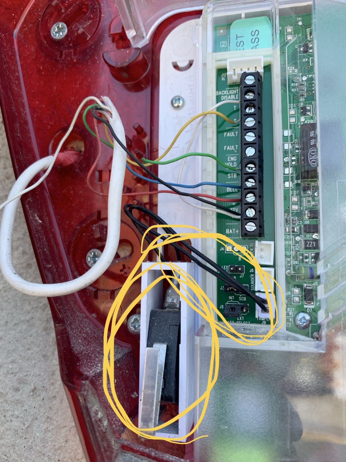

Pyronix had a problem with tamper switches. Your bell box many have one of those faulty tamper switches. You need to replace the tamper switch on your bell box or link the tamper switch out in the bell box.
Because the bell box has rang and you could not disable it points me to the tamper switch.
What colour is the tamper switch ?
Ah ok. Yes I linked in main control panel TR and Ov.
The tamper switch you can see on the pic, it's bottom LHS and plugs into the circuit board. Not sure what you mean what colour is it.
Really hope its this, happy to unplug it from circuit board of it is, would that be enough for the system to ignore it?
