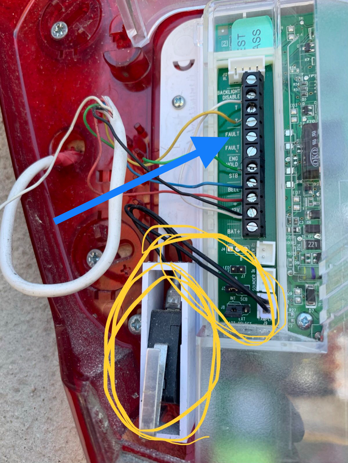

Alarm (internal) went off when not set - tamper
Buy a new microswitch of ebay and just connect the leads to the spade connectors
Ah ok looks a standard microswitch then. Is removing it off the bell box circuit board enough to link it out, as it it won't see it so ignore or would I need to put a jumper on, or twist the wires together?

If you remove the tamper switch then you must link it out.
This can be done by putting a little black jumper on the connection when you in plug it from the pcb or short the Microsoft leads together.

Looks a poor connection on the tamper terminal
Thanks will have another check, but I think I went down them all today, as I've said the ladder wasn't really tall enough, but your right that looks screwed out further than the rest.
So even if I have TR and 0v linked in main panel (I believe to link bell box tamper out as shown in example diagram from manual), I'd still need a link in bell box tamper? This I don't understand.
**Edit** just looked at pic again and it is screwed in it's just angle, so the 2nd and 3rd screen are where wires are and they are screwed in
As I understand the siren requires 12v.
The positive from the panel goes direct to the external siren + terminal.
The negative from the panel goes through the normally closed tamper switch then to the siren - terminal.
If the tamper switch is opened the siren loses its negative 0v and activates using its own internal battery. Therefore if you have faulty tamper switch it will trigger the siren every time the switch is open.
The reason the external siren has its own internal battery is so that if the cable was cut or the control panel was ripped off the wall the siren would activate.
If you cut the black cables going to the tamper switch strip them and twist them together (it just needs a closed circuit), it will sort the tamper fault out obviously it won't be tampered anymore though.
The yellow Tamp wire wouldn’t cause the bell to ring outside as reported ...it’s only a return signal 0v wire ..only a loss of 0v , 12v + or the tamper switch to open ....
Think next to do when get better ladder is to either replace or link out bell box tamper, remove my links in main panel, leave sounders disconnected and see if anything triggers.
Sorry to confirm my official fault is this correct?
Alarm wasn't set and then only internal siren went off, not external, RKP showed tamper.
So if the tamper in bell box is faulty/tripping/intermittent, this wouldn't set off the external bell box siren off just the internal? I would have thought it would do both sirens?
