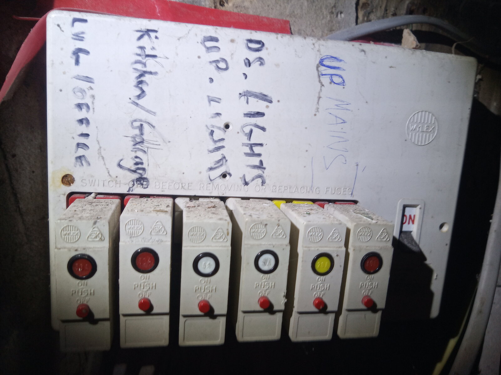

Hello! I am doing some work on my loft, boarding it and need to disconnect the wires which are resting on the joists. Every time I trip the upstairs lighting circuit on the fuse box the alarm goes off. Pushing the fuse button back stops the siren.
The problem is I do not know the code to reset it as the previous house owner did not give it to me. So the alarm has never been manually activated by me.
What can I do?
More than likely the battery is fault in control panel.
Totally power alarm system down while you are boarding loft.
start by giving the make and model of your system, and attaching some photos.
Certainly. It's Eurosec PR5208 rev 1.0. There is a control panel and box, the box goes off when you try to remove the two screws. Then I just reset it by tripping the lighting circuit fuse and pushing it in again. When I trip it, the panel box beep goes off but the siren panel on the front house exterior goes off. Then pushing it in silences it. Here are the pics

Thats what I would like to do, but I dont know how to properly disconnect it from the light circuit upstairs, and I dont want to risk having it go off again and annoying the whole street!

How do I do that without shutting down the mains for the whole house? I try to trip the circuit for the light, which is all I care about, and the alarm starts siren.
Would the siren not have a backup battery inside?, ours does
