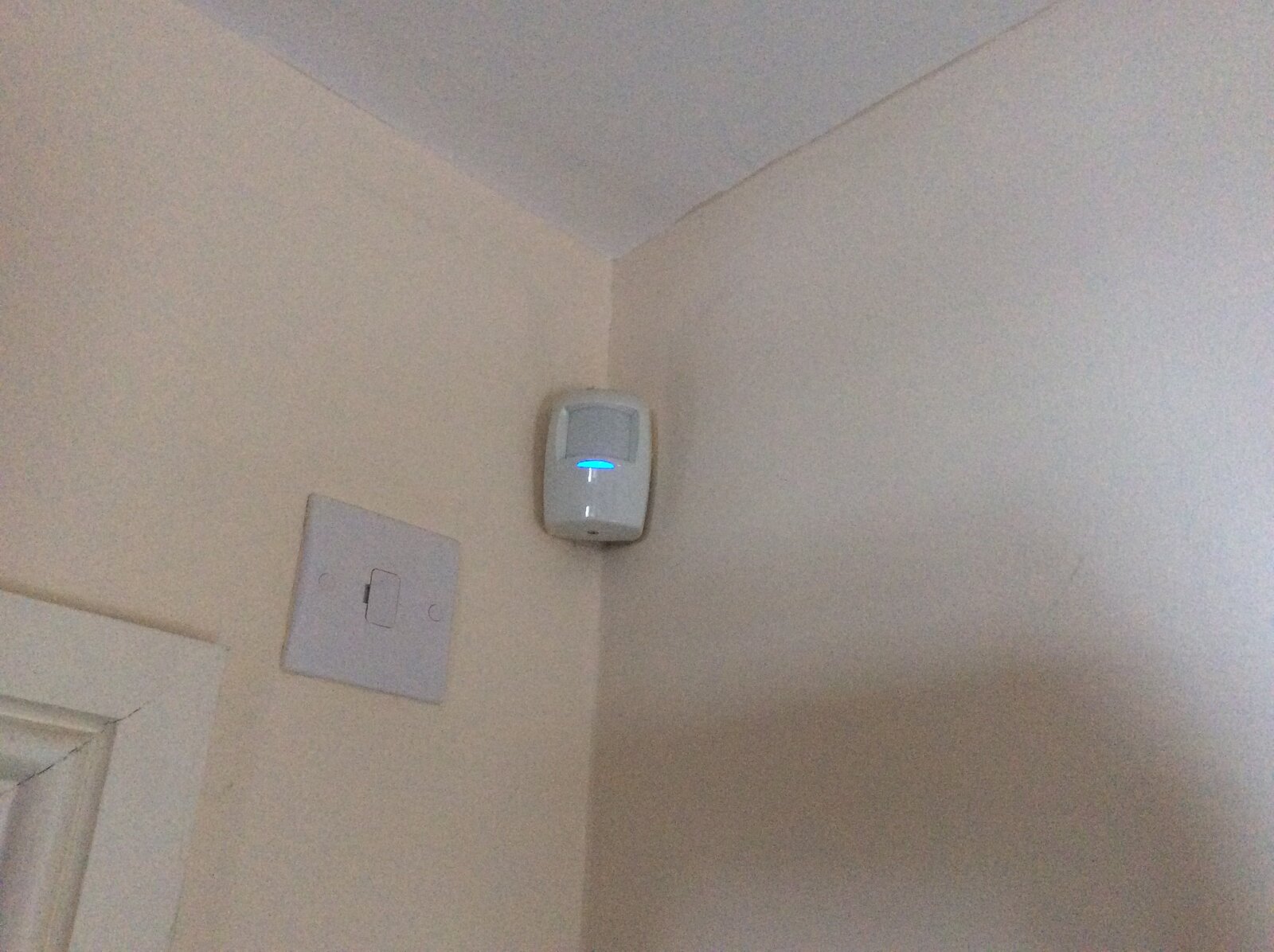

Good afternoon,
I think my wife mentioned it going off and I’ve encountered my house alarm sounding upon my return. Both times when I’ve put the code in to cancel it comes up Landing. I’ve inspected the landing PIR, landing area and my girls bedrooms and nothing seems obvious to be setting it off.
The alarm I think is a Castle Euro mini with blue led PIR’s, similar if not the same as these. Age is 15 years old. I replaced the battery in the Control box circa December 2023.
Any pointers? @sparkymarka - old threads seem your knowledge is abundant.
Spider inside the detector ? Window open on landing curtains flapping in the wind ?
No, we don’t go out with any windows open. I’d have to open the detector up to check for a spider. I’ve had a glance around and can’t see any.
I take it the alarm was set ?
Yes mate, omitting the dining room where the dog is kept. Would it be worth swapping the detector for another functional one if I find no spider or dust? We had an engineer out some years ago and he replaced the hallway one. Do you know if these are reliable?
Budget detector but not a troublesome detector, have a fair few in the field including the version before with the red LED have replaced a few over the years ….
