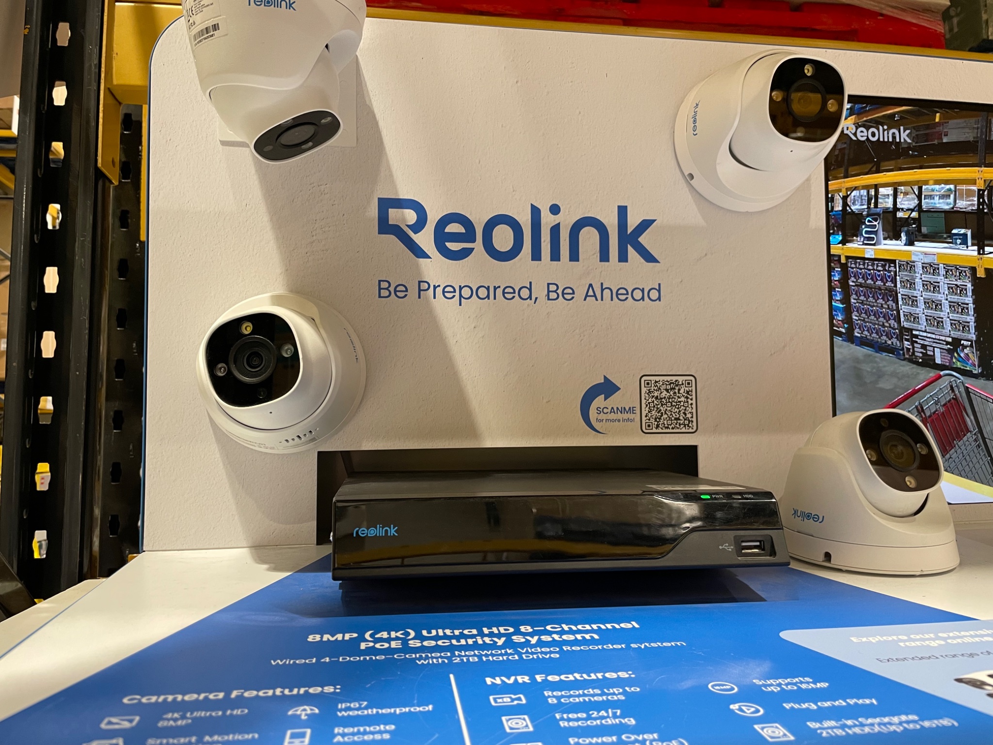

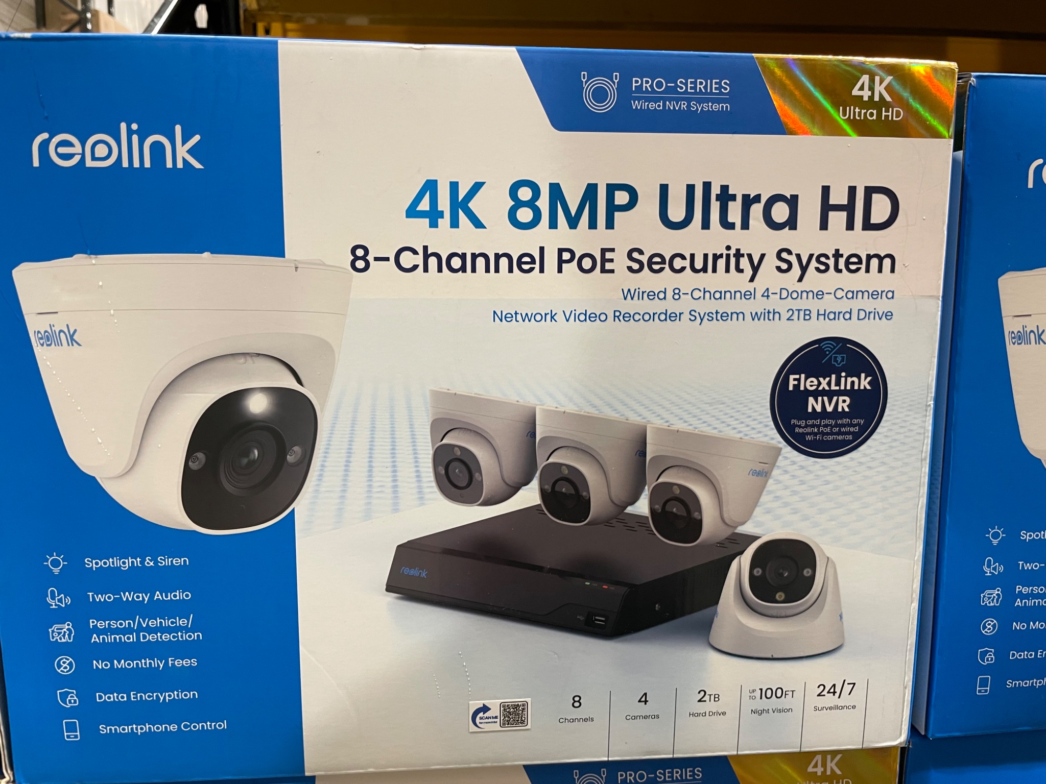

Would a kit like this be an option?

£329 sounds pretty good to me and the manufacturer is generally well regarded so I wouldn’t have any concerns about getting that combo unit.

The number of cameras and resolution of them determines the size of the hard drive and days that can be recorded.
4 x 4k cameras at 20 fps is going to go through 2TB pretty quick

So 264 or 265 compression, we don’t recommend 265+ for example, but 265 is usually okay and will save space.
I have seen some reolink footage and live views, depends on models and setup as to how good it is. On a remote building covering a large area camera okay in the day for seeing someone but night time wasn’t so good, sane canera in a internal space well illuminated was much better.
I can’t stress enough, it’s the right camera/ setup for what you want to achieve.
