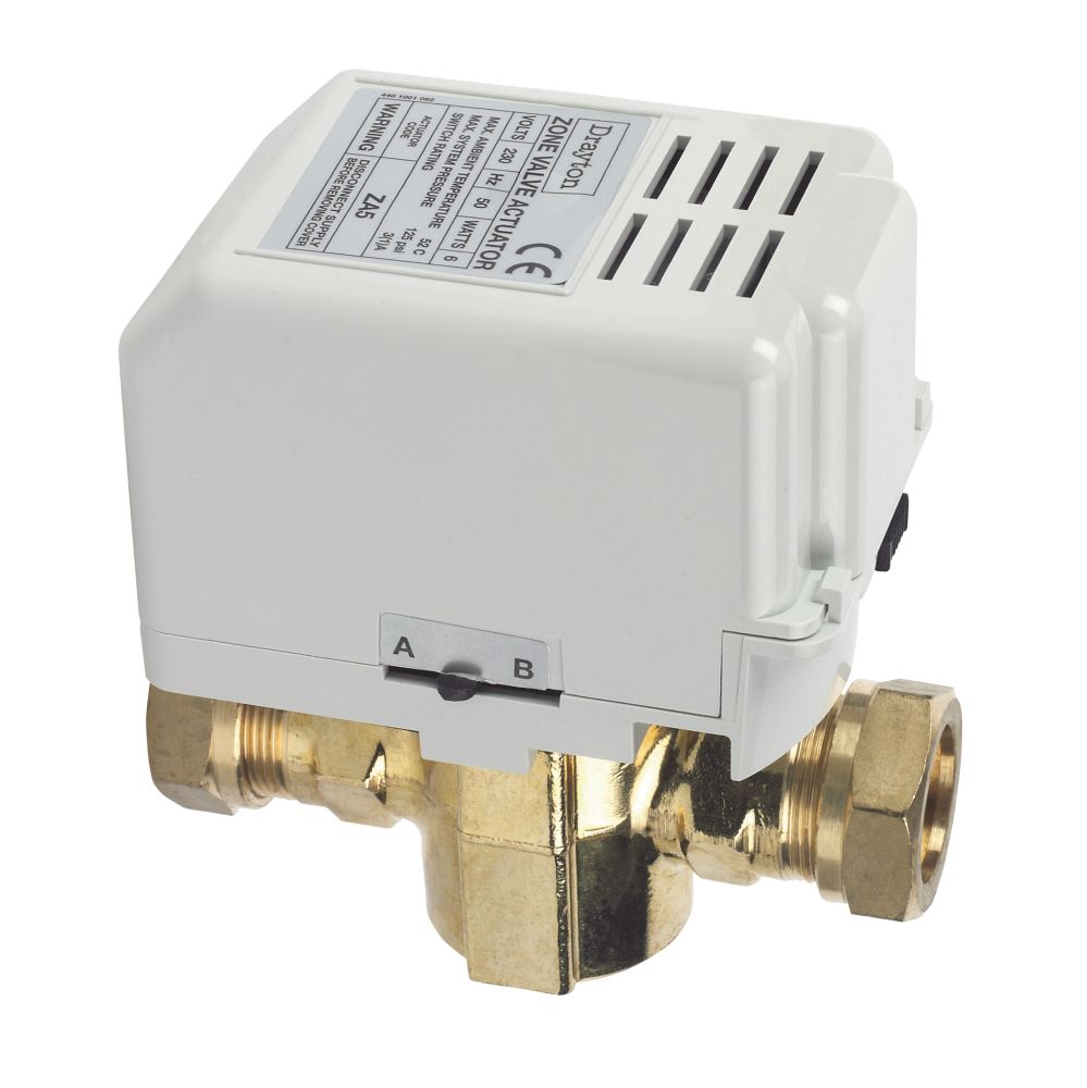

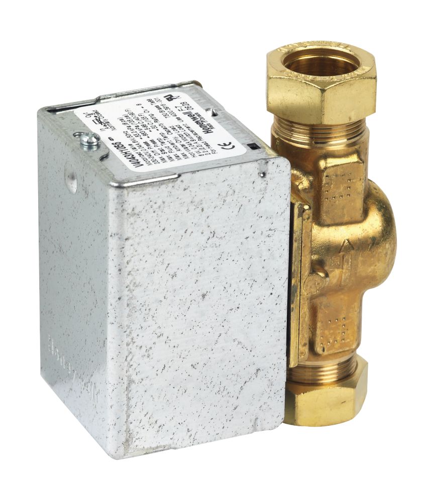

Can you see any motorized valves anywhere? 1 pipe in, 1 pipe out (2 port) or 1 pipe in, " pipes out (3 port)
