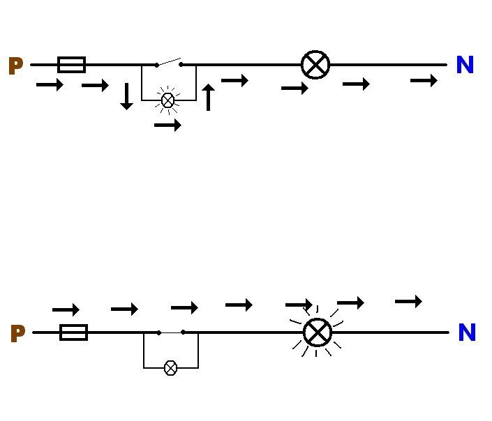

I'm fitting a MK light switch that has a neon indicator in it but I want the neon to come on when the switch is off (as a switch locator in the dark).
As there is no neutral feed in the switch, if the neon is across live in and SW live out will it be on when the switch is off and vice versa.
Has anyone done this before a different way?
One of the sparks will explain more...
but AFAIK it won't work as the neutral would only be available when the light is off.
Tho I may be very wrong :roll:
If the switch is off (open) then the neon is effectively connected in series with the lamp, so the noen will light up, but the very small amount of current that neon uses is not enough to light the lamp.
If the switch is on (closed) then the lower resistance of the switch means the current flows through the switch rather than the neon, there is then no PD between the legs of the neon, so it will not light.
And dont forget that there will actually now be a shock hazard at the light fitting when the lamp is TURNED OFF.
Why not use the MK switch locator product. What it says on the tin is "Neon locator available making switch easy to find in darkened rooms".
Or take a neutral to the switch, wot you replace with a 2-way.
It would also work if you connect the neon between permanent live and earth, but there's probably a reg against that.. :?
