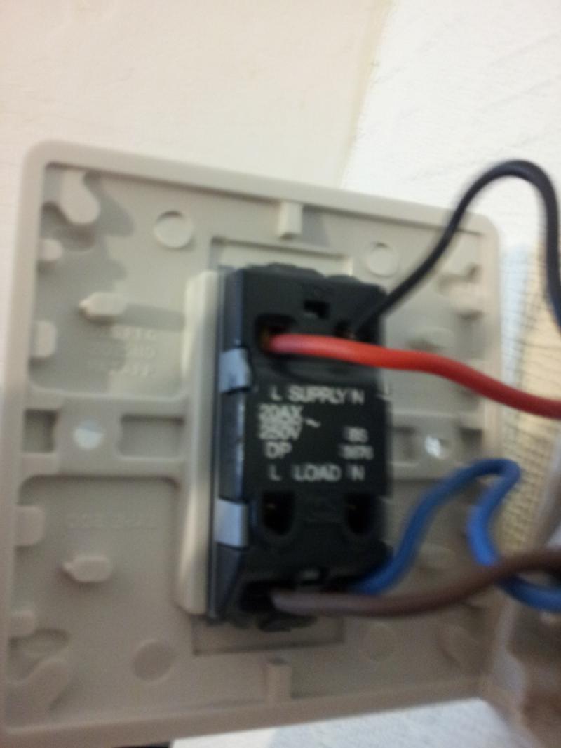

Wiring a light switch with a neon light
I felt obliged to provide an update for future reference – I’m pretty sure someone else out there will be trying to achieve the same…..
Thanks to sparkwright for providing a meaningful comment on the post and no thanks to a certain someone – mentioning no names :LOL:
So with a bit of work and some new wiring I got the switch to work the way I wanted (without blowing anything up) – actually it was dead simple. Here’s what you need to do in plain English – you need one main live feed cable (two core + earth) in the switch and one cable that runs between your switch and ceiling rose/bulb holder. The live and neural need to be fed in to the correct terminals on the switch (see below pictures) – the main live feed will go in SUPPLY terminals and the other cable will go into the correct L and N terminals for LOAD.
If you only see one cable in your switch back box then the neon indicator switch will NOT work for you as your Neutrals are looped in the ceiling rose. I hope this will help someone someday.

The original cable in your switch is the permanent live (red) and switched live (black) You don;t have a neutral. You have the wrong type of switch. This has been pointed out by BAS, Sparkwright and pjcomp.
Look at the second drawing in the ligthing sticki and you should see where the line and neutrals go. Where did you get the neutral form and how have you wired the circuit to get the red into the load L and black into load N?

He has briefly outlined what he has done.
It would appear he has rerouted the perm live and neutral that went to the light to the switch position.
It would then appear he has run a new harmonised cable from the switch to the light position, and removed the old switch cable.
It would appear VK has done his homework and learnt how to do it himself. Good on him.
I'm curious as to where VK got the live feed and whether any testing was done on this new circuitry. He has the circuit energised whilst the faceplate is hanging off the wall, so I doubt he's learnt any more than he thought he needed.
VK, you could have sved the effort and bought an MK Neon Locator and achieved your required results in about 5 minutes.

If it was me, I would have swapped out the Twin & Earth cable from the 'rose' to the switch with a Three Core & Earth cable, using one core as a neutral.
It appears the cable is dropped in a stud wall, so easy to do this.
I hope you have joined the earths in the back box?

As far as I can remeber it was wired across the switch, using the switched live as dummy neutral.
Is my recollection wrong as I don't believe the strips glowed permanently?
Yeah I know them as switch locators. They do work as you describe, but they are a horrible invention leaving the wiring live even when the switch is off :evil:
However, they are an alternative to rewiring and would give VK what he was looking for. I would be interested in what testing VK has carried out.
