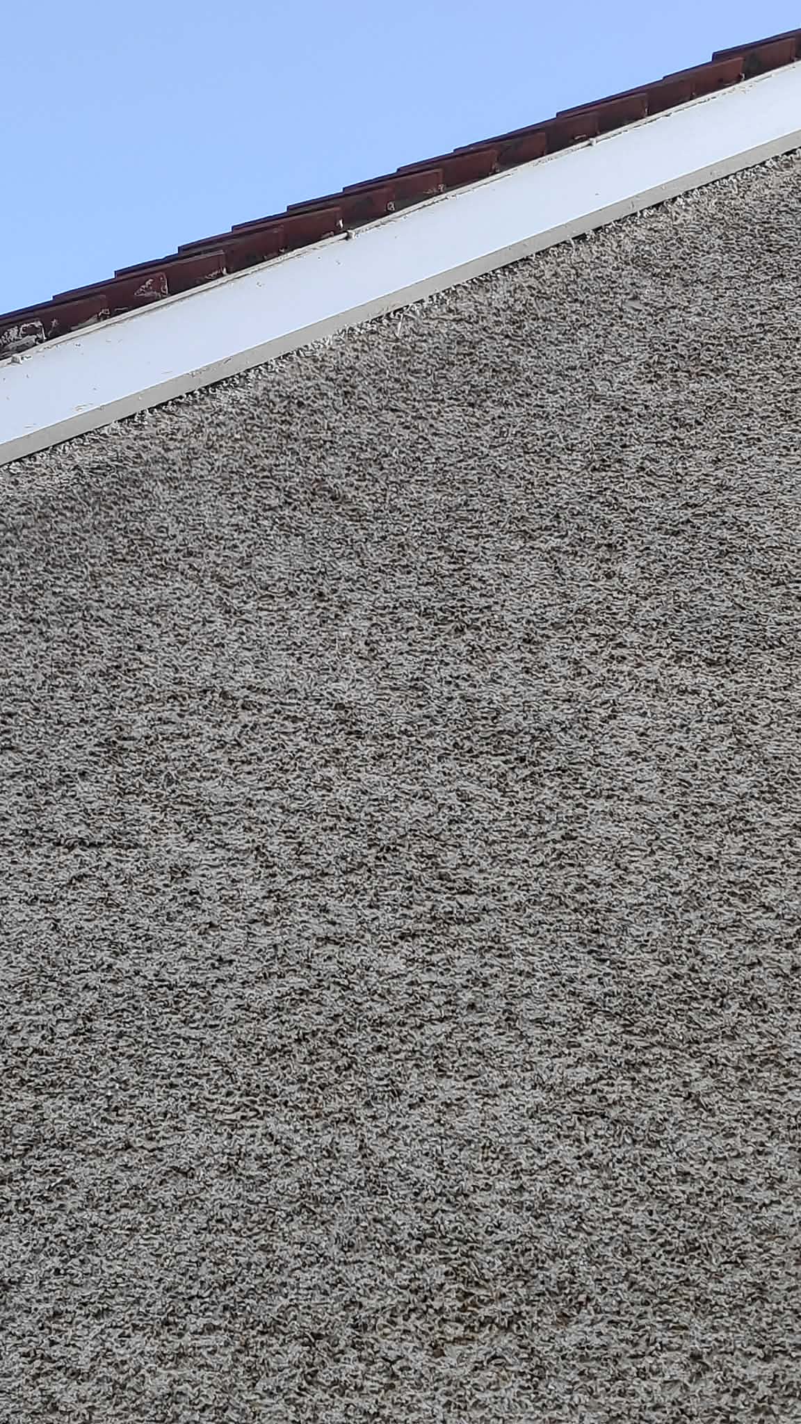

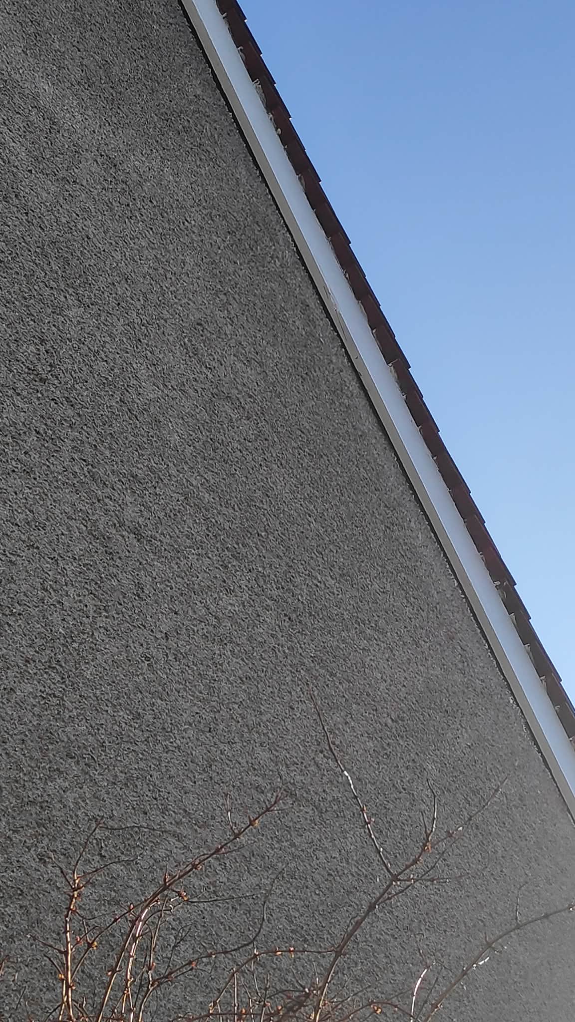

Hello all,
I came across this site the other day and the timing is probably not coincidence - I'm looking for advice or maybe even reassurance. Having moved from a small flat to a (1975) 2 bedroom end-terrace Dormer property, there's a mounting list of things I'm picking up on despite a glowing home report. Reality is setting in and I find I'm freaking out over just about every little thing.
Left gable slope is what I'd assume to look normal. The right hand side there's a clear space/gap. What is the reality of this please?
Thank you,
StressedUser

That gap needs to be filled in or covered. Otherwise, the whole thing may blow off in windy conditions.
You could perhaps get some dry verge fitted but the overhang looks loke it would make things more difficult than usual. Ask a roofers to have a look.
Thank you for the feedback everyone. Much appreciated.
I'm seeing other houses in the area with what I now understand as a 'Dry Verge'. I'll look in to that some more once we're settled and stable.
