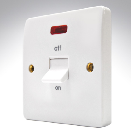

I will find out maybe tomorrow. I know the CU has an RCD and a dedicated mcb. For arguments sake, say the mcb is 32A with the cable say 6mm all the way (or say the cable can take 7.2 kW) I read here that the diversity factor dictates it is fine and the 20A isolator is fine. It is the very same as this one, MK, that is how I know it is 20A.

These MK 20A switches do not break unless someone throws the switch.
So if it's a 32A MCB and a 32A load, it should of course be the 32A switch.
Quite normal on a cooker circuit. For some reason the wrong switch may have been fitted, perhaps by somebody who didn't know better.
I would agree that 32A minimum switch should be used. But is this safe? Will the contacts of the 20A switch melt if the hob is run at maximum, the whole 7.2kW. I have a gut feeling the cable is OK and the mcb is OK, it just the switch which is in question.
maybe they would. The maker is under no obligation to sell a product whose performance exceeds its rating.
You sometimes see old switches where the contacts are burned or the springs have softened, though I think this can be due to dirt or tarnish. Long ago you used to find platinum points in some switchgear, and gold in certain telephone switches. I haven't heard of either lately.
In reality, almost certainly not. However, if, for some reason, you tried switching that switch off whilst the hob was running at that maximum load, you could get arcing aross the cointacts, leading to the switch contacts welding together (i.e. 'permanently on').
