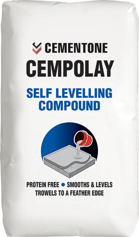

Hey Guys
so i have been looking for some self leveling stuff and found this local to me for £10 a bag? still in date and as many bags as I need
Cempolay Self Levelling Compound 25kg bag
•Protein-free suitable for use in hygiene and food preparation areas
•Smooths and levels up to 15 mm thickness
•Trowels to a feather edge
•For interior use
just wondering if this will do the job.
and yes i shall be having a liquid dpm down first
I have been asked to look to see if i can supply a good quality self level, and I would like your thoughts on this brand
Yes mate its ok that. Used it before. It's a water mix so will flow well. It can't be used under a dpm though just ontop.
Get someone mixing for you Jay. Easier that way.

just looking over many brands of liquid dpm to use, and not sure which to go with! are any or all types compatible with the cempolay self level cement i will be using, as it is a water based mix.
just had a guy come over this morning to price up for the screeding job. he is more than happy to let me do the supplying of the materials and he is doing the work.
but he is going to try and better the price i can get the 25kg bags of cempolay for, and i forgot to ask re the dpm type needed.
so anyone with ideas as to what i can or can not use would be great, as I am going see if i can get the recommended stuff. .
liquid dpm over the entire floor area 60m2 area.
it shall be going onto solid concrete floor, with no known dpm underneath as it is an old house.
but one area ( the conservatory =18m2 ) has got dpm under the concrete floor
so any ideas would be fab, or am i asking a silly question? and any liquid dpm would be fine
