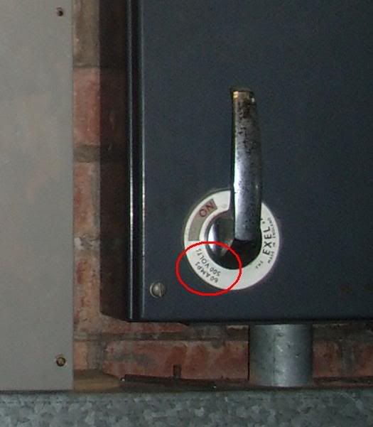

Yeah, MEM Exel were definatly 500V rated, and I think MEM Glasgow were as well.
No, the MEM Glasgow were rated to 1000V and installed with a bottle of scotch next to them.

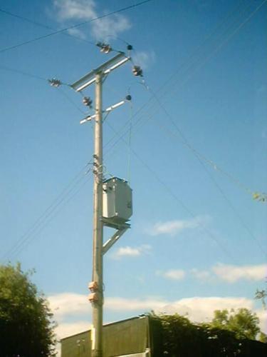

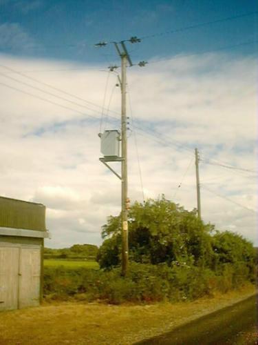

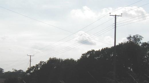

Pole mounted TX - two HV overhead phases. (11kv).

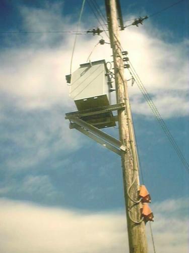

Closer view of terminations - notice two fuses for each of the split phases.
Closer view of terminations. I have labelled so you can see, as pics not too clear. Should take my camera really. Notice the cable used is a split concentric three phase type (it will likely be waveform, but cannot tell obviously). The grey is unused and just clipped to the pole. The end is not terminated.
Service head. Standard TPN service head used.
Service head with the cover off. Here is the issue. The supply should be TN-S. It was requested and designed as TN-S, but the DNO chappy who fitted the service head has fitted one with combined N/E. After discussions with the DNO designer, he has decided to use the unused grey as a neutral, using a solid link in place of a fuse in the service head. (withdrawable). The blue/bare concentrics can then be used soley as the earth.

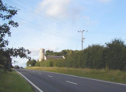

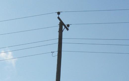

There are quite a few 1-ph 3-w 240/480V distribution systems in use around my area of rural Norfolk. I dug out these photos from a few years ago - Not the greatest quality as I think they were taken with a little pocket camera, but you can clearly see the 3-wire arrangement and two fuses on the pole:

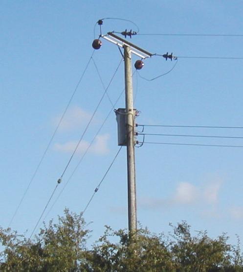

And here's another one a few miles away from the first - A PME connection is clearly visible on the neutral in the third picture:
