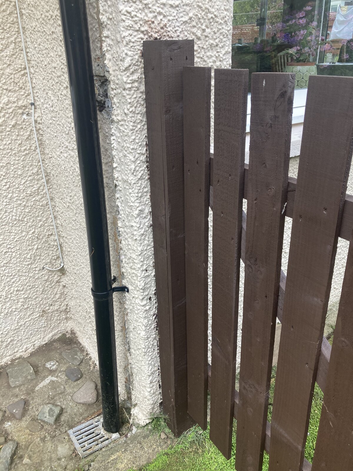

I used a 4x3 fence pole, and drilled the hole for the bolt, then an inch deep countersunk hole big enough for the head of the socket screw. After it was fitted, ( and it’s solid) I screwed a 100mm fence slat over the top of it to cover all the holes

Thanks for your help. This concrete bolt looks great, so you didn’t have to pilot hole into the brickwork prior to screwing this through the timber, and wall?
