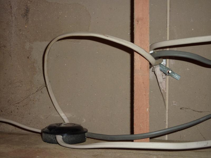

There is a junction box but this has four cables coming from it so not sure if this is suitable.
Depends what those 4 cables are....
How you do it will depend on how your lighting circuit is wired.
More modern installs use 'loop in' wiring.
Older ones have a big junction box hidden under the floor somewhere.
The above methods are where lighting circuits tend to start out.
If they have been added to or modified there are many sneaky ways of doing things.

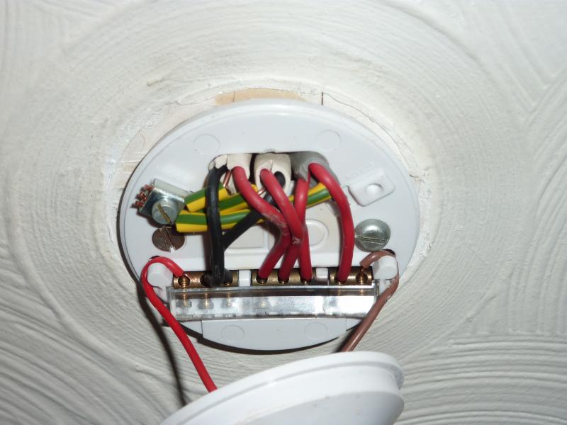

Unscrew the cover of your existing ceiling rose and take a picture for us to see. Then we'll have an idea of the starting position.
Your pic shows that you do have a lighting circuit wired as a loop in system. This is good news - you can follow the diagrams in the WIKI!
So, you have one rose & one switch at the moment?
Tapping off for an extra rose is easy: just connect a T&E cable to the terminals in the rose that feed the lamp. Don't forget the earth.

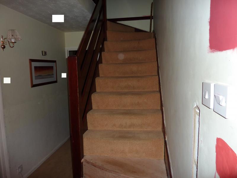

That's right, one rose in the hall, not shown in pic but directly above my head, controlled by one switch of the three gang on the right of the pic. New positions of rose etc are marked in white. Disruption to decor is not a problem but time is against me.

That's going to be a tight squeeze. It might be better to rationalise what's going on with the associated junction box (e.g. the switch drop cable already goes through it) and make all the connections there, as per the 2nd diagram here: //www.diynot.com/wiki/electrics:lighting-circuit-layouts
and just take one twin & earth to each rose. That would also pay dividends in the future if ever light fittings with only L/N/E were to be installed.
If it isn't already a 2-way switch, the 3-gang needs to be replaced with one which is, or both switches replaced by a 4-gang 2-way, which might look better.
Then you are going to have to add 3-core & earth running from there to the two new switch positions, i.e. up the wall, through the floor, and up & down the wall on the other side of the hall.
