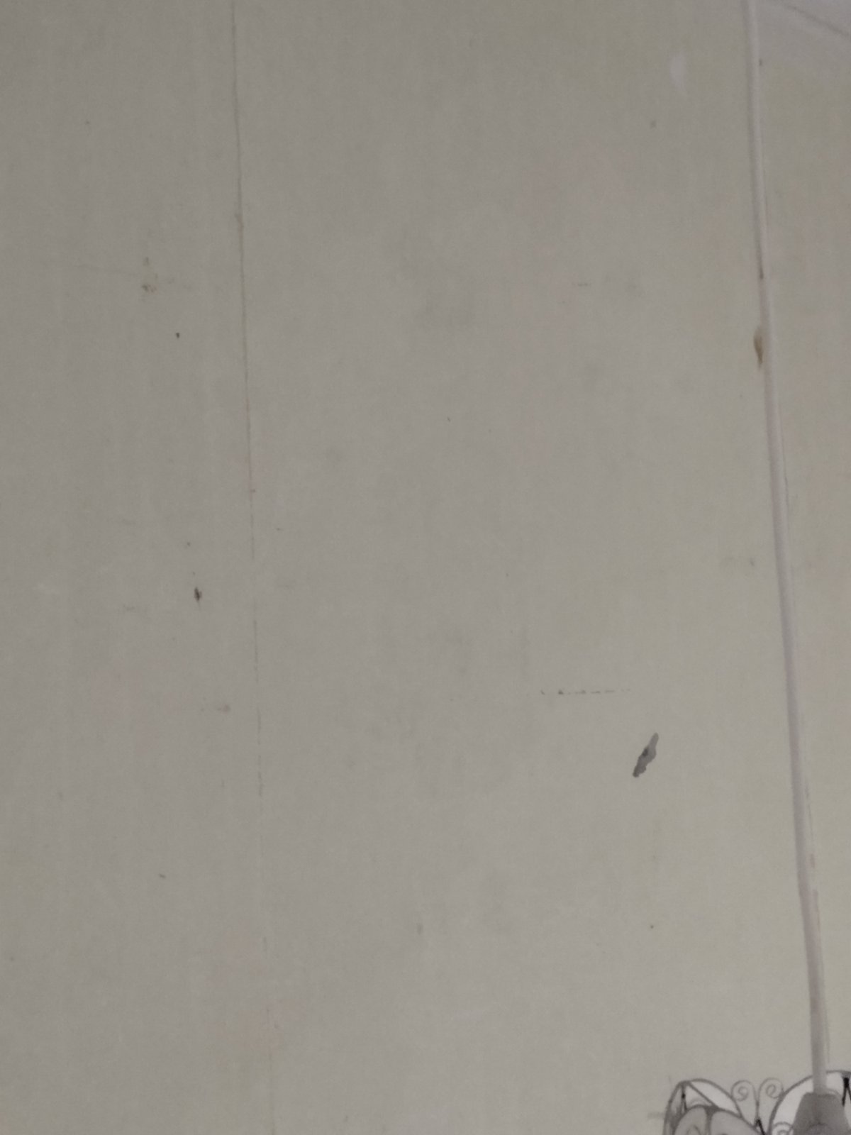

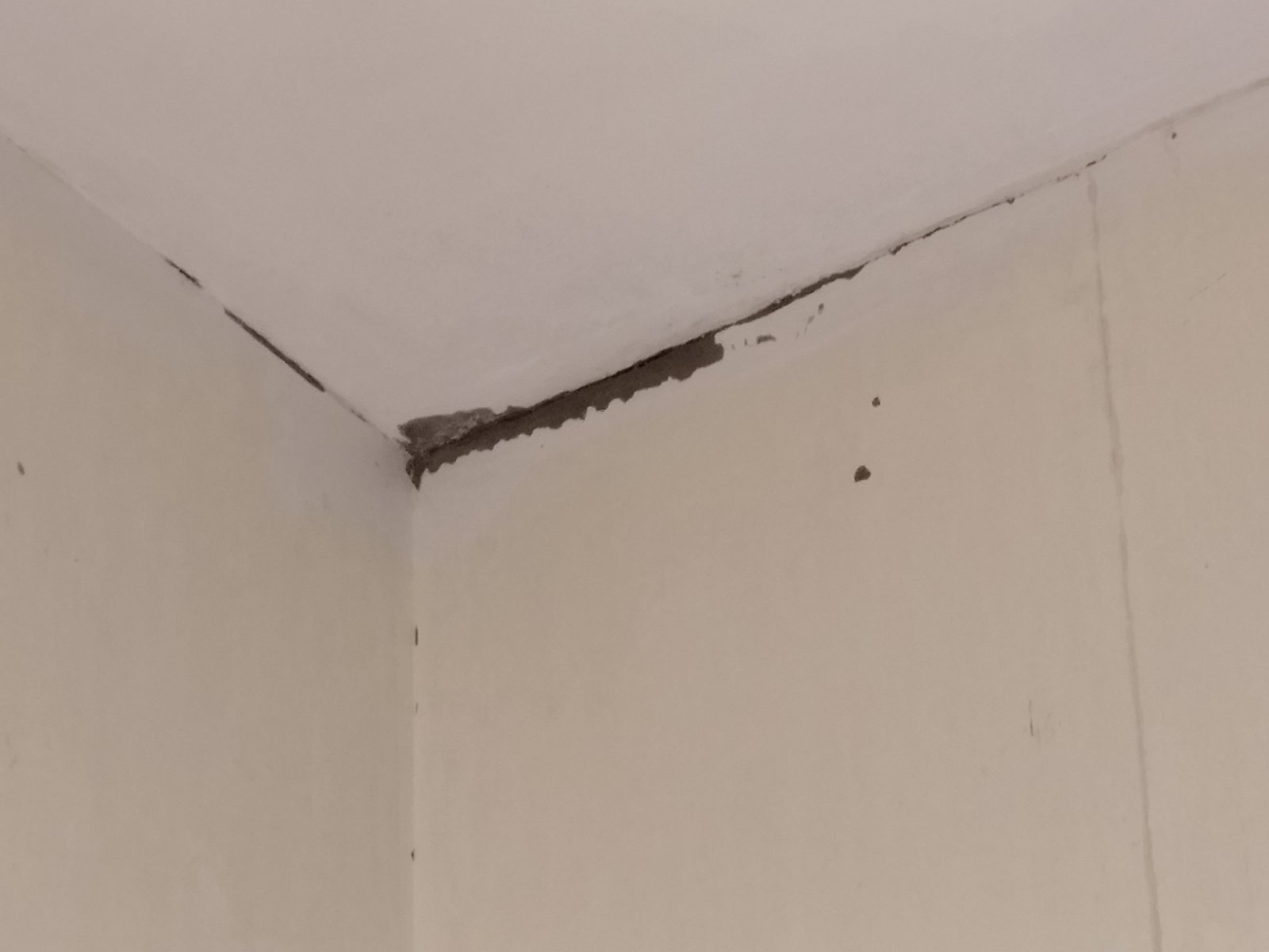

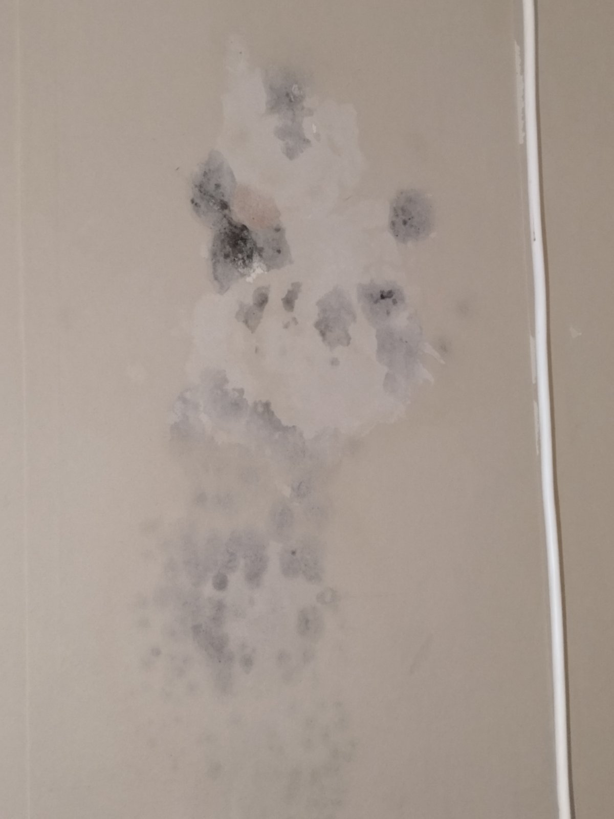

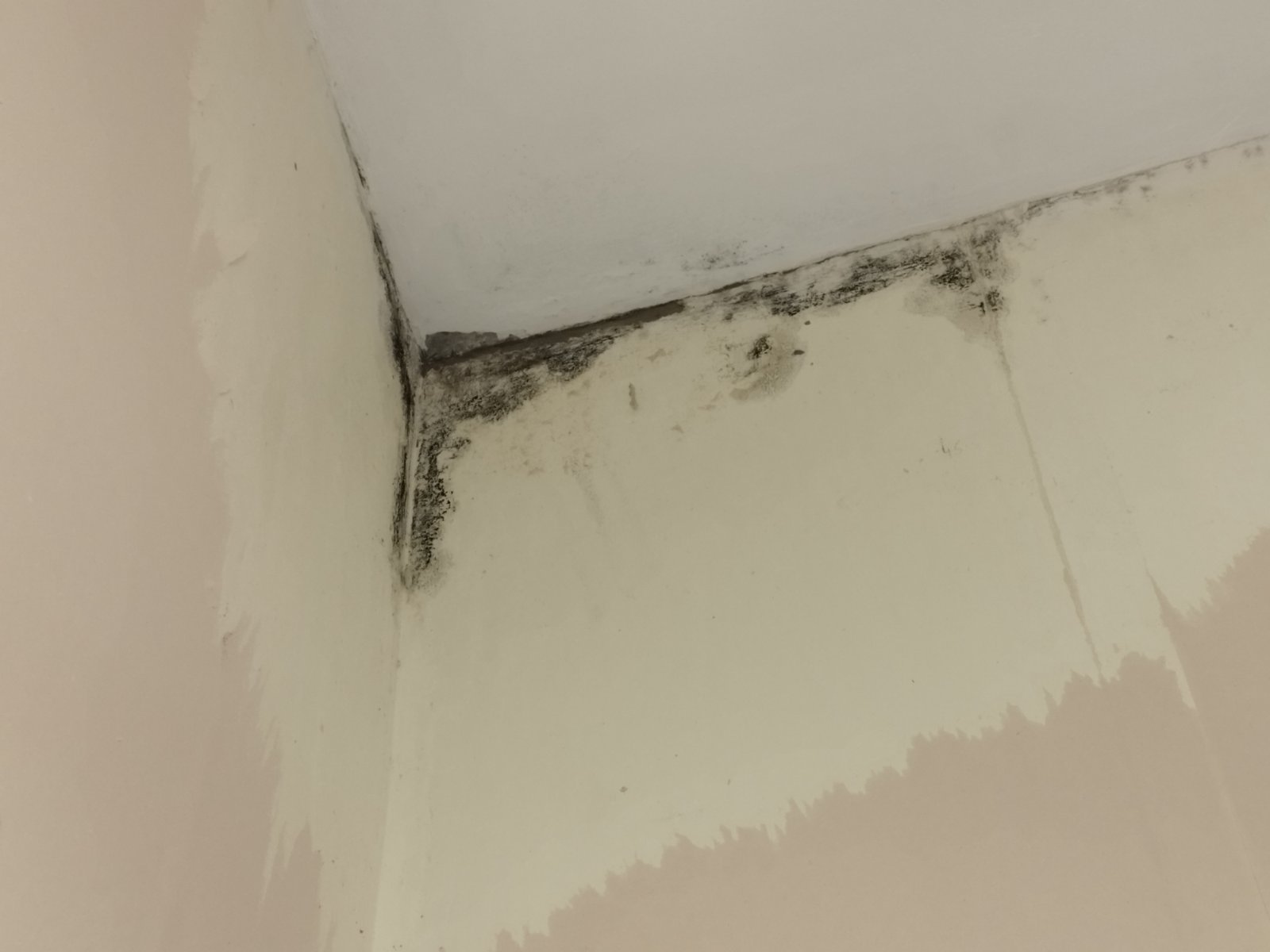

First one is the damp/mould in top corner of internal wall. We have CWI & rendered walls. Where we live we do get lots of wind driven rain against the house. What's the best way of finding out if that is the case or would it be better to get a professional in?
This looks like water ingress to me, because the mould is concentrated in one area. If it was equally bad all along the ceiling, it might be because of clothes drying, etc, but it's not.
Things to check for:
- condition of pointing.
- check gutters aren't broken so water is running down the wall.
- check for broken tiles and potential roof leaks that may be putting water into the wall.
Many thanks for all the replies& suggestions.
We bought a dehumidifier & it has been going mostly non stop over the weekend.
I borrowed a ladder & got to look at the pointing on that corner. A chunk was cracked & loose so removed & repointed as best as i could do. Waiting to hear back from a couple of roofers to come round & look at it & a couple of other issues i have seen.
Cleaned all the areas that had mould on, so hopefully with what i have done & the dehumidifier that will potentially solve the issue.

There was mould on quite a bit of the wall, just not as prevalent as the corner.
