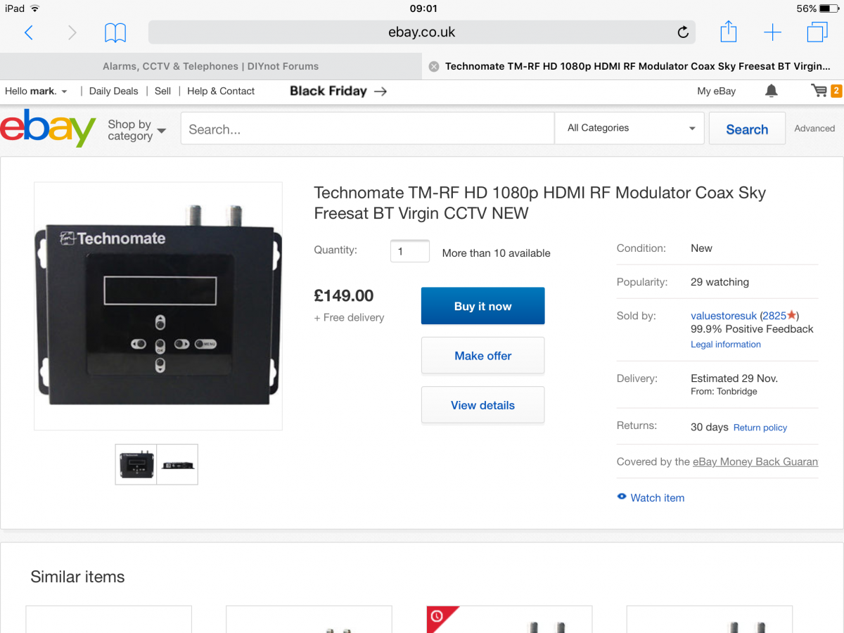

Dvb modulator ?
Thanx sparky

HDMI splitter won't really do the trick you will need a 4x4 matrix or use the dvb modular.
